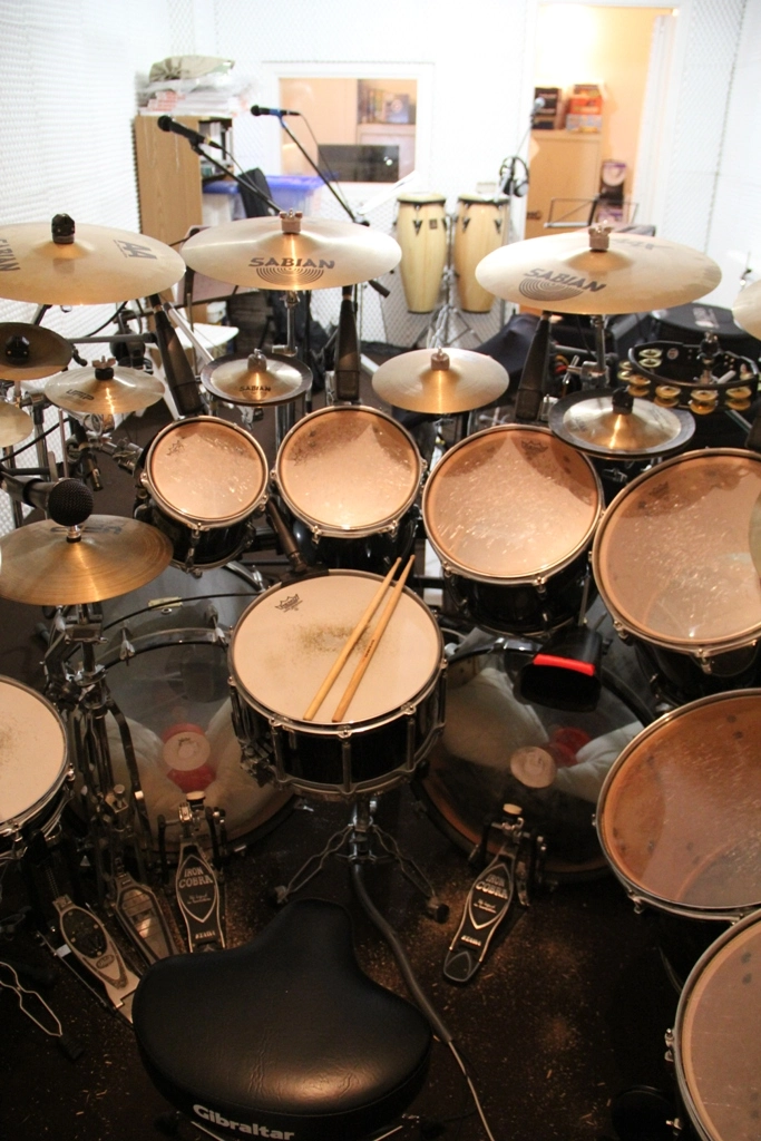

I have a small home recording studio, where my drums is permanently miked. The mics signals go directly to another room into 2 x M-Audio Profire 2626, connected to a PC with ProTools. That is fine for recording: 14 slots are taken by the drums, 2 slots are left free for any other use (vocals, guitars, etc.). You can see a view from my throne.
