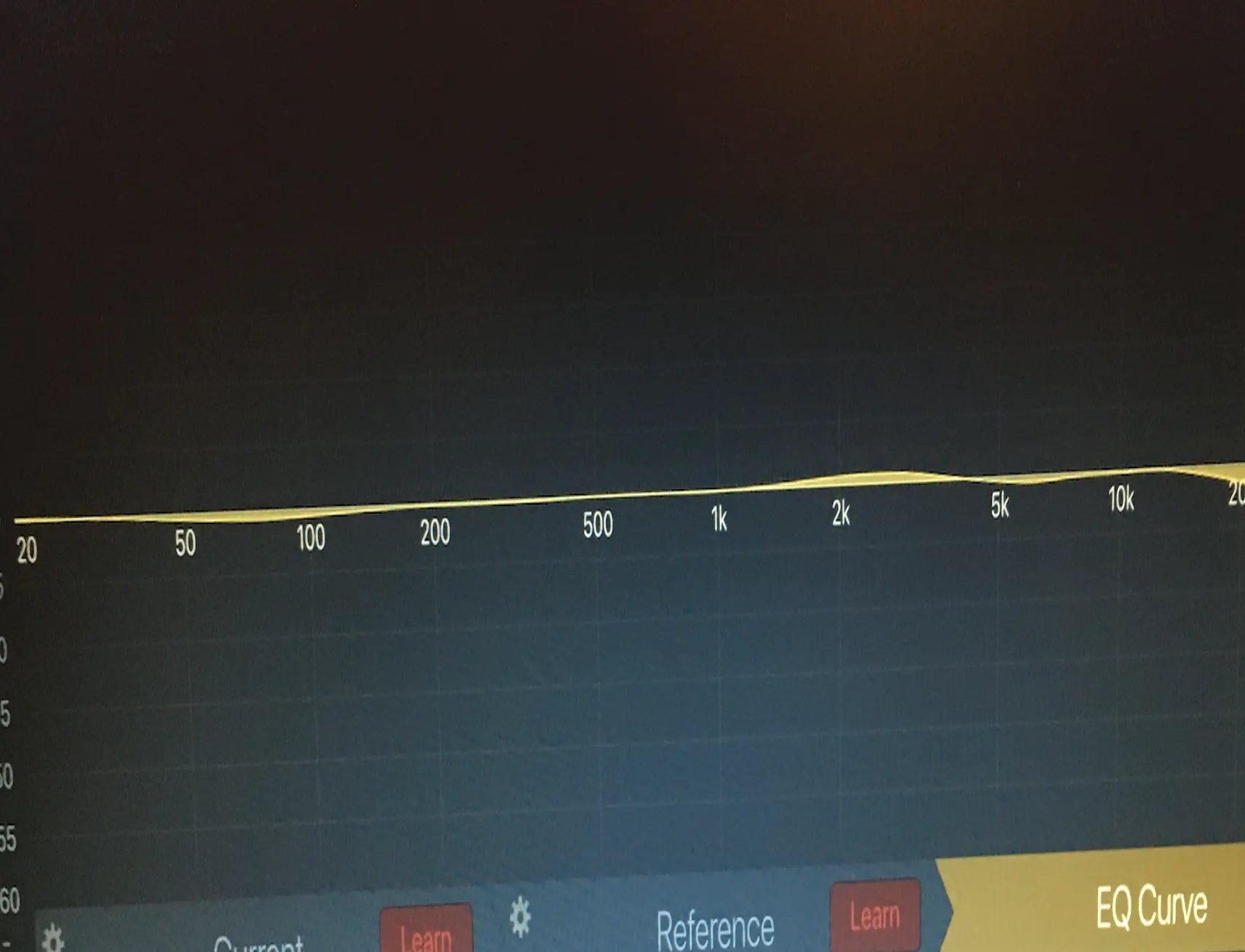

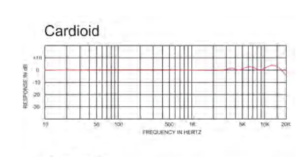

Here is what CAD says their M179 looks like in Cardioid mode and what I measured it at compared to a measurement mic with pink noise as the source.
I smoothed mine so it is comparable. The peak around 3500 hz looks similar but where they indicate another at around 6500, I have a slight dip??
Some other manufactures plots match much closer to what I measure, but all manufactures are smoothed a lot.
