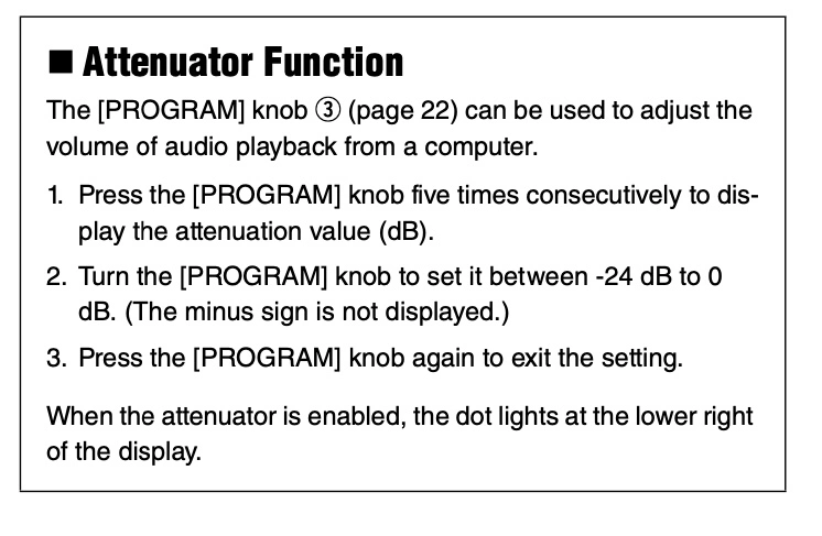

Hey guys! New here and not really an audiophile. Just trying to figure out how to set up a live music stream system. But I can't get it to work properly. I have a Rode NT1 with a Mac and MG10XU. I connected the MG10XU to my Mac via the USB 2.0 to USB 3.0 port. I can get signal and everything fine. When I monitor my audio and look at the bars I am at the correct level (About -6 and 0) I hear myself loud and clear as well. But when I am testing out recording my audio on garage band - the replay is very soft. I tweak up the volume on GB and it's still soft (not inaudible but not the level I want it to be). I tried it on Streamlabs OBS as well and audio that audience hears is very low as well.
Hearing the music instrumental playback on my Mac is very soft through my headphones as well. I turned it all the way up already... Is there a way to monitoring my Mac audio louder and mic audio softer? Or is that not possible and I will need the 12XU for that? I see other streamers using the MG10XU fine with their live settings and mic and I'm wondering if I am doing anything wrong - or if I do need to drop extra for the 12XU...
