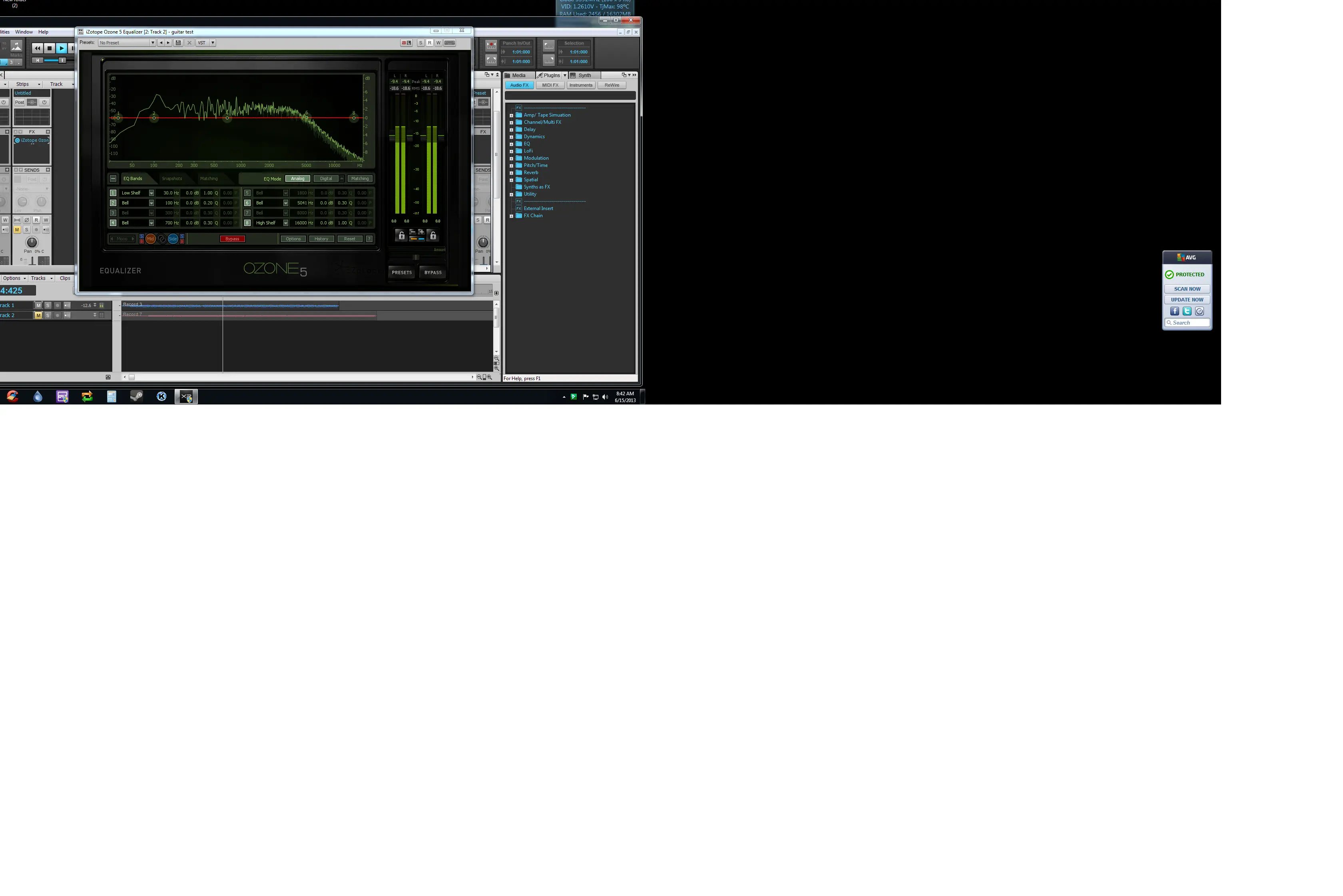

i noticed that on my guitar tracks when i'm using my eq plug in, that the frequencies start to taper off big time after 5khz. is this normal? it's almost as though i've done a pass on the high end, but did not. i'm using a M audio c600 fast track, from the emulated speaker out put on my amp. i just don't see how my frequencies are being dug down. but again maybe this is normal for guitar and i just don't know it. from about 5khz its a 45 degree angle down, by the time it gets to 12khz it's through the floor. hope someone can explain this one.

(B) I'm still convinced that trying to mix with your eyes is the fastest way to slow you down the most... Meters are for calibration - otherwise, they're really not doing you any favors. That said, it's probably not a bad thing to understand what's going on as far as a typical 1/f curve, which is pretty much what you're seeing.
Even pink noise is going to have a curve similar to that. I wouldn't want to hear a guitar tone that had considerable amounts of energy up that high. Heck, I wouldn't want to hear anything that had considerable amounts of energy up that high.
So, let's turn this into a learning experience -- You probably have some sort of signal generator. Create a -20dBFS PINK noise file and a -20dBFS WHITE noise file. Load them on a track so you're looping maybe 10 seconds of each one over and over. Watch and LISTEN and compare.
Yes, it's normal for newbies to get caught up in how things look rather than how they sound.
A passive guitar pickup connected to an amplifier with a cable is a low pass filter which usually rolls of in that area. A guitar amp's speaker is also a low pass filter which usually drops off in that area and "speaker emulation" is usually a low pass filter which drops of in a manner similar to a speaker. This is more than normal. It's desireable. I'd be willing to bet that if you actually heard any of the harmonics coming off the strings or generated in the overdrive/distortion of the amp above 5K you would hate it!

that's the thing, it doesn't sound as good as i feel it should. the guitar never sounds very "up front" i don't use reverb for any other effects. my audio interface is very sensitive , i have to turn it all the way down or the signal is too hot. i ordered a DI box and i'm going to try use it in front of the interface, i read some stuff on how it can help achieve a brighter sound.
thanks that helps me some. i was thinkin this was related to my problem of weak sounding guitar tracks. i can rule that out. i hope the DI box helps. maybe i just have a shit interface. (M-Audio Fast Track C600)
