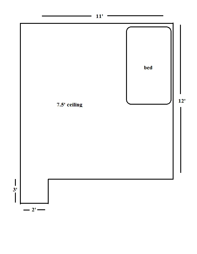

So, I was a little bit off with my estimate. Here is a rough diagram of my room. I decided, if it is really necessary, I could get rid of all the furniture besides my bed (my room is signficantly smaller with the furniture around the walls).
If I go through with this, does anyone have advice on how to treat the room? Where should I position my mixing station, amps, etc.? Is it big enough to record drums in as well?

I would move the bed to the bottom right and position your mixing position along the 11' length, but I'm still not sure if you could fit a drumset in there. A typical kit takes up AT LEAST 6' x 4' for a small one. The large room seems the best bet for recording, I take it it is your living room?

One thing I should've mentioned is that I have two windows--one in the middle of the top wall and one in the bottom right (on the right-hand wall). I would prefer not to cover the windows with treatment. Does that change anything? Should I angle the monitors so that they aren't pointing directly at the window in the bottom right?
Any advice for treating this room (in the diagram I posted)? It will be used for both recording (mostly vocals and guitar cabs, maybe bass cabs as well) and mixing. Is there any way to make a room this size (7.5' ceiling) sound decent, without making it completely anechoic?
The basics are:
* As many corner bass traps as you can manage, including wall-ceiling and wall-floor corners.
* Absorbers at the side-wall and ceiling early reflection points.
* Absorbers or diffusers on the rear wall behind you.
Do that and your small room can be fine. More elaboration here:
Acoustic Basics
Also, small rooms need to be mostly dead. A large room can give a pleasing ambience, but small room ambience usually sounds like a small room. Better to make it mostly dead, then you can add better quality reverb and ambience with plug-ins while mixing.

Thanks Ethan. A few more specific questions:
- How would you recommend treating the little cut-away in the bottom-left corner of the room? It seems like a place a lot of bass energy could accumulate there, since there are two corners right next to each other. I can't treat both corners (unless I use foam) because the treatment would block the door from opening. One option is to set up a large bass trap with a stand, blocking off (most of) that area while I am recording or monitoring--would that help?
- Say the mixing desk is on the north side of the room. I would want absorbers at first-reflection points, on either side wall and on the ceiling. Where should I put guitar/bass amps with respect to the mixing desk--is there any way to do it so that there is "overlap" between the reflection points? Or will I simply need to treat the amps in a similar fashion? Besides first-reflection points, are there any other "rules of thumb" for setting up absorbers/diffusers throughout the room?

A panel on a stand would work well in that area in the corner. It will still sound quite boomy standing back there, but the goal is to get it so that it doesn't affect mix decisions.
There is no 'first reflection point' that needs treatment for an amp per-se. First reflection point treatment is for critical monitoring, not necessarily for recording. As any time you move the mic you're changing where the 'first reflection' points are. Also, many amp speakers are more directional than a typical monitor loudspeaker, so first reflections of an amp would be much lower gain than typical early reflection points. The better idea is just to use panels in front of or around the amp so that no loud reflections can be recorded by the mic.
As already recommended, you should try to treat the room as much as possible with trapping in every corner available plus walls and ceiling treated as much as possible - not just reflection points. This will make the available living space smaller, but you will have better results from your mixing.
Remember that most of the above recommended treatment is ONLY a starting point.. minimum, if you will. That's what you need to start making it accurate in that room.

Right now I have 4 GIK Monster bass traps as well as 10 2x4 2" OC703 panels. I am planning to make frames for the 2" panels so that they have a 2" air pocket in the back, and I might combine a few of them to make two 4" panels for the ceiling (since it would be lighter without the wooden frame).
So altogether there would be one bass trap in each corner, 6 2" panels with 2" air pocket on the walls and 2 4" panels on the ceiling (for early reflection points). How is that for starters? Do I need any additional bass traps for the corners? Should I look into getting diffusers?
..... So altogether there would be one bass trap in each corner, 6 2" panels with 2" air pocket on the walls and 2 4" panels on the ceiling (for early reflection points). How is that for starters? Do I need any additional bass traps for the corners? Should I look into getting diffusers?
It's a great start! Diffusers; I don't know. What are shooting for? RFZ? if so, then yes. You should definitely trap the back wall as you do not want hard reflections from there. Definitely look to be putting up corner traps.
That's definitely a good start. I would look into doing some full thick traps in the corners like the TriTraps or Soffits to get under 80 Hz.
I would look to double up some of those traps to 4" thick - 2" helps with high end reflections a bit but really doesn't give full range treatment. The air gaps will also help a little bit. Diffusors can be helpful for breaking up flutter echo and other reflection problems without deadening the room, but can also be used to provide good diffuse returns to listening position depending on what you're shooting for and how far you are from them.
How far will you be from the back wall?
I am trying to create a reflection-free zone for the listening position, but also to deaden the room and tighten the bass in general, for tracking loud guitar cabs and vocals. The listening position will be around 9' or 10' from the back wall.
