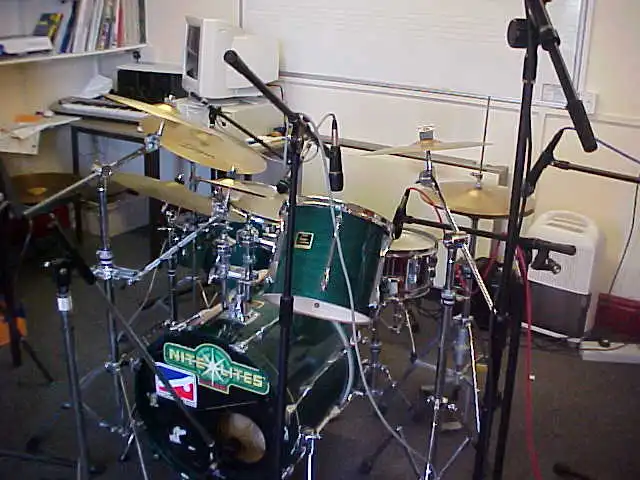

i like the guitar sound generally but not too happy with the drums. there is 4 tracks of drums, stereo overhead, bass and snare (and maybe a hihat, i cant recall).
the recording was done all together, except for vocals, in the same room.
:: mics ::
2x akg c1000s for the overheads.
cad ndm 10/11 for the snare and bass drum
cad ndm 11 [?] on guitar one. the first one that comes in.
shure sm57 guitar 2. cleaner one.
direct out from bass amp.
singers roland mic for vocals.
i have a rode nt1 available also if needed.
ooo i even have a photo here. this does not show the final positioning. and the mics on the floor tom and hi tom were later removed.
and would reflections off that back wall be affecting the sound in a bad way?
thanks for any feedback!
