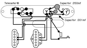

This is the wiring diagram for your Tele.
take the pickguard off and confirm everything os OK.
Sounds like the bridge ground wire isn't properly connected. Follow the diagram from the grounding of the jack. A wire should go to the metal bridge. This will make the hum stop when you touch the strings.
