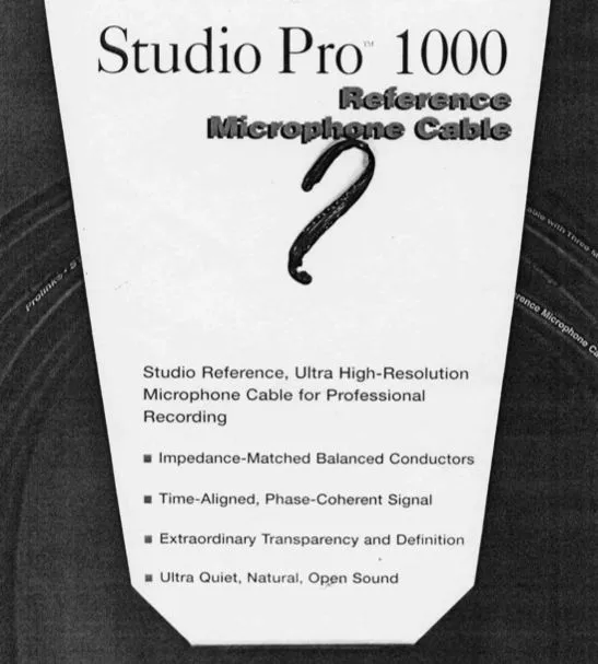

This is in responce to a dude that thought the time aligned cable was a gimick or something. Its very much real and it's some really nice stuff to work with those nice mics you all have : )
check it out!

i have no idea what that means. Since you say it isn't marketing hype, can you explain exactly what "time aligned phase coherent" means. And how some cable is and some cable isn't? If you could lay a little of the physics on us, it would be appreciated.
for instance, if you buy mogami or canare bulk reels (like probably 90% of the top studios in the world) and make your own cables, are you making time-misaligned or phase non-coherent ones?
I think I need a little more than a picture of Monster's marketing slogans to convince me.
i have no problem with paying more for quality of shielding, robustness, or oxidation resistent wire - but please help me understand all this other mystical stuff.
well.........the theory basics of it i can understand, but getting down to how its done and what the total effect in spec writing is a bit over my head right now.......im not an electrician, I will try to get this information from some of the big egg heads i know to break it all down. I was just wanting to show this to a guy (forgot his name) that wanted to know what it was. It has to do with the frequencies being sent through it ariving all at the same time (from the source, to the mic pre or whatever). I guess if you really want that perfect (no phased) signal then this would be an answer........ill get more info on this soon : )

I hope this helps.........it helped me
An analog audio signal passing through a copper cable succumbs to this law of physics in which bass frequencies tend to gravitate towards the center of the cable; higher frequencies are forced to the outer portion of the cable. The higher mass bass frequencies create a magnetic field in the center of the cable while traveling through the conductor, which impedes those lower frequencies. This impedance forces those lower frequencies to arrive at their destiny (the speaker or amp) delayed, which causes a mild distortion in the waveform. Time aligned cable utilizes multiple gauge windings to help compensate for this distortion. Large, solid-core copper strands in the center for bass frequencies (containing higher mass) and smaller gauges wrapped around the solid core conductor to delay the mid’s and high’s ensuring that the entire bandwidth of frequencies arrive in uniform.

Do a blind A/B test with identical sources and compare expensive monster cable to inexpensive but good quality normal cable. Chances are you won't be able to tell the difference, you will be left guessing. It’s all hype.
But if you have a dual channel o-scope (I got one here at work in the Tech lab...) you can inject a LF (say 100hz) and HF signal (say 3000 hz) across the cable and set the O-scope to display the waveforms of both ends on its screen. I would be REALLY surprised if there would be any significant phase difference between the signals at the 2 ends.
Voltage travels through a 50 foot cable in nearly 0.00000005 seconds (depending on the insulation).
Even if the HF is traveling 10 times slower than the LF (which I bet it is not), would we even hear a difference? We are talking about HF arriving 0.00000050 seconds after the LF. There are other factors that weigh in much more than this ever would, like tweeters being closer to the listener than woofers in typical listening arrangements. (Edit: I should have said tweeters being further away!)
I am guessing you wouldn't notice any phase effects till you started to measure your cables length by the mile…
Of course I am just speculating here. An A/B test or an O-Scope test would prove that all monster has going for it is marketing hype.
Admittedly not being a physics degree holder, I've still got to admit that my tendency is to agree with Gunther and Blue Bear. It really sounds like a load of crap, and even if there was a kernel of truth to it, it would be so negligeable as to make spending 5x per foot of cable extremely cost inefficient, especially compared to throwing that extra money at other acoustic problems.

I hear from lots of people that they can "hear" a difference using these Monster cables. I haven't done the blind test for myself yet, but im thinking on just getting one of these cables just for the H of it. Actually when i do get it ill try to post an A/B between that cable using a sm57 on my guitar cab to a decent cable or something.
eh.........ill see what i can do............does anyone else use this stuff yet for anything and noticed any worth while improvments?
