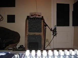

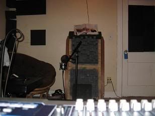

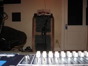

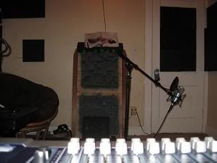

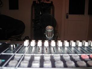

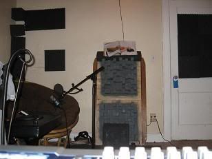

1) I recorded three long ringing chords. Each chord rings for 8 beats, or two full measures.
2) I placed a condensor microphone in my room directly in front of my DAW facing the speakers. I played back the previous recording so that the mic would pick up the sound from my monitors and record what it hears to a separate track.
3) Repeat step two several more times, but each time I moved the mic around so that it got farther and farther from the source and is pointing less and less toward the source. I now have a total of 8 tracks if you include the original recording.
4) Now, I manually move each track so that instead of them all playing at the same time, it plays one each beat... Remember how I told you each chord rang out for 8 beats.... well now I have a version of that chord playing on each beat.
5) Last part of the process. Go through each of my eight tracks and set the panning on each. The 1st track starts hard panned to the left, and each track after that fades farther and farther to the right so that by track 8, it is hard panned right.
Now when you play it back, the chords just ring out and kind of spin all around you.... I have to run some errands right now, but I will post up the pictures of each of my 7 mic placements now, and you guys can check my myspace page later to hear this. This is a really exciting project for me. I'm sending some wave files to my good frined in Manhattan tonight so he can add some Bjork style beats to it. Hope this gives you guys some new ideas.

You know, after I spent a few hours to record this simple idea, I started to wonder that myself. I tihnk it could be simulated to an extent, but in actuality it would have taken even longer. If I had done it that way I would have had to record the initial track, make 7 more copies of it. Set all the panning for each track. Then set the volumes for each track. Then mess with the reverb and EQ of each track. If you look back through the pictures you'll notice on the last few placements, I had the mic right in front of my diffusors which changed the sound drastically, then practically inside my huge chair which I did to absorb bass on the last few chords. So in theory I would have had to make several EQ adjustments to simulate this type of thing. I like the old-school approach better. :)
You know it was weird because I had the input and output volumes the same for each track as I recorded them, and the sound level went down a little each time due to being further from the source or pointing at it less or what have you... but when I moved to the placement directly in front of the diffusors, the sound level jumped up about 50% from the position before it. Not sure what all attributed to that, but I thought it was a rather interesting anomaly.
