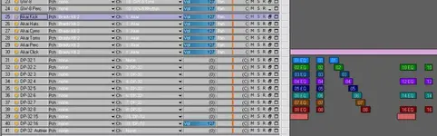

Sonar track layout: the 4 fader groups collectively use channels 1 - 8, bank changes on 15, the main fader is on 16, and one more channel set to Omni for recording/playing realtime automix events.
i have small clips with various controllers which i can edit, copy and slide around wherever i need. the pic shows all of bank0 and part of bank1 - after the bank change clips on channel 15, there's a small block each for EQ, effects and for fader/pan. the paired tracks on the Tascam only use the even-numbered midi channels, so the odd ones are missing in banks 1-3 which explains the gaps in the pic
this setup is efficient in that i can edit it easily and quickly, but the initial starting 'desk mix' still has to be entered by hand for each new song, so as mentioned above i want to find a way of speeding this up
