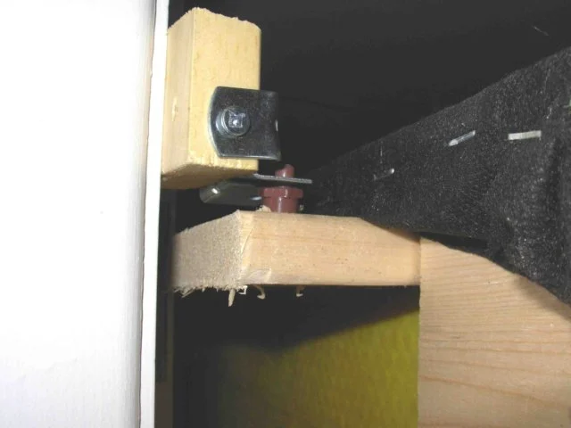

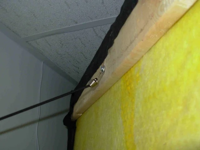

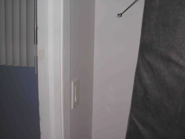

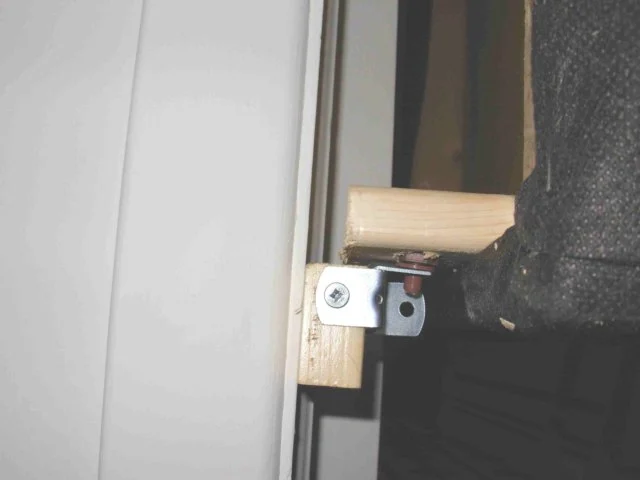

I had that problem where the door of my room was right at the first reflection point. I solved this problem with a pivot system.
Pictures will explain much better what I did then words.
