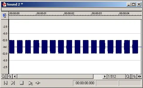

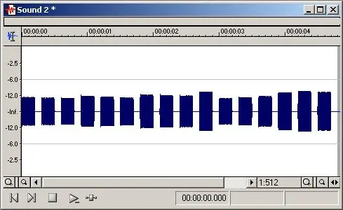

There will be places in the signal where a negative peak of one frequency lines up with a positive peak of another frequency so that the actual signal peak level is lowered at that spot. If you filter out one of the frequencies the other will peak higher.
Here's an example using DTMF (because it has more than one frequency at a time). First pic is a DTMF string at -12dBFS without filtering:
Second pic is the same file with a steep 1kHz HPF applied:
The peak level of the whole file actually goes up 2.1dB, from -12dBFS to -9.9dBFS.
