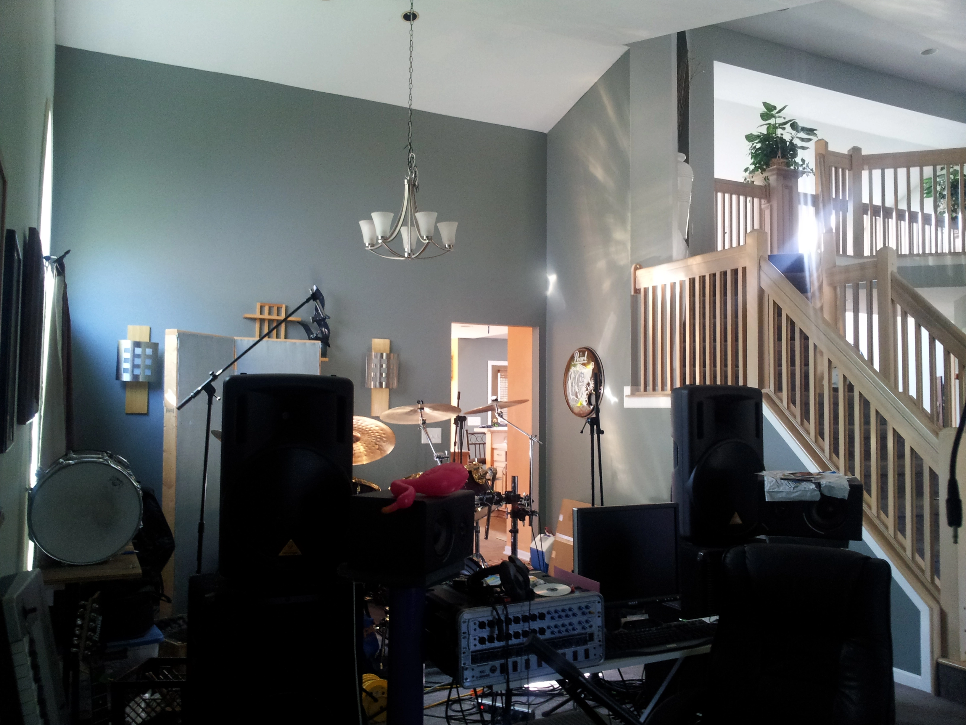

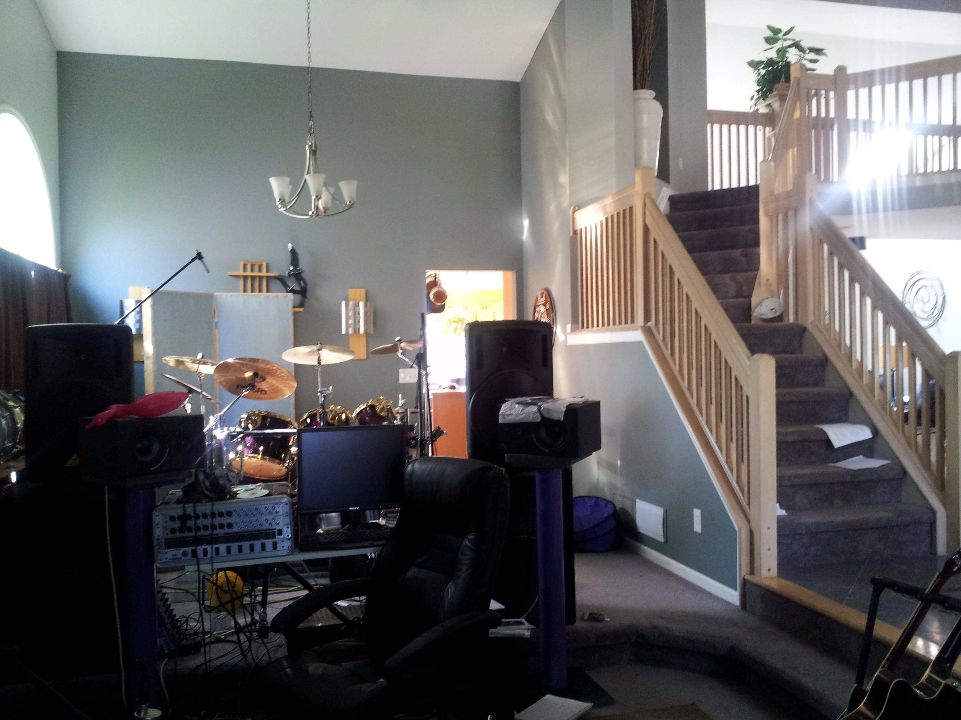

here is my space.. yes.. it's large and high.. I took the pics up against the back wall and as you can see, the right side is completely open and has 16 foot tall ceilings. Right now, my desk and monitors are in the middle of the space, but i've noticed a lack of bass ( maybe I have the opposite problem that many of you have... )
1. how would you treat this space if at all?
2. should my monitors and desk be up against ( or a few feet out from ) a wall to get some bass bounce back?
I recommend staying away from walls. I would also recommend using something other than Behringer PA speakers, or any PA speakers unless they are configured properly (real subs and a crossover to start). PA speakers have higher priorities than accurate full spectrum sound at moderate output levels.
oh LOL.. those are PA speakers for when the band practices... it's dark but you just make out the Alesis MkII's on the stands in front the Behringers :)
Oh, that's better. I still say stay away from walls if you can. And I agree with Jimmy about the near wall on the left. You could treat it but it will always be asymmetrical sounding.
Think in terms of inverse square law. Doubling distance quarters power. Quarter power = -6dB. Compare the shortest reflection paths to the direct path from your speakers to your ears. The bigger the ratio reflected:direct the better.
And I would orient the monitors vertically.
Post a pic of the side of the room behind you in the photo. Generally, it is said that around a third of the rooms longest dimension, is considered best location for your monitors, though the openness of the one side throws a bit of a wrench in here. Is there a wall on both sides, from your pic taking position? That might be best for symmetry.

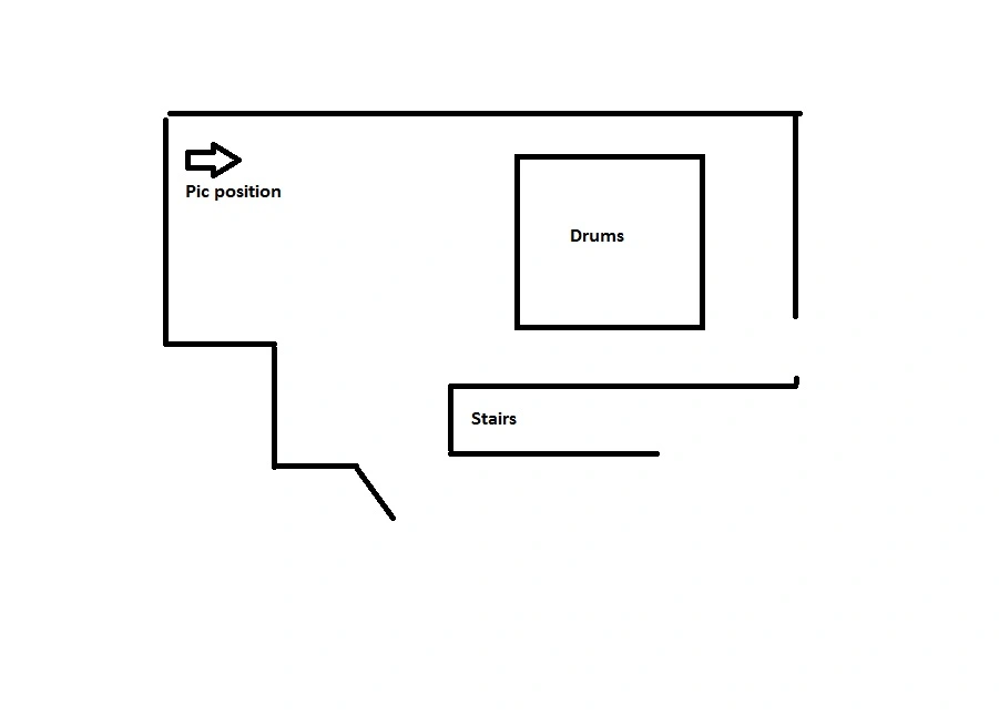

Here is a quick drawing of the room... you can see the 2 other walls ( one behind me in the picture and one to my left...)

It is awesome that you have these high ceilings for drum recording, but from my knowledge, it is going to be tough to find optimal listening position for mixing. That being said, there is no reason you cant make it work.
My little brain says for you to setup about a foot or more from the wall to the left of the drawing. As far out as you can, and still see your monitors in a mirror from your listening position, on the left side wall. Place an absorber there, and on the opposite side.
Do those monitors have ports in the rear? Typically not great for being close to a wall, though it may help with your initial comments about lack of low end. Once again though, it is going to be testing of the room acoustics, that will be the only way to find out exactly why you have nulls and peaks going on in that room. Controlling it, or at least getting in the most likely 'good' spot, should be your objective now. Though again, this is just my experience, I am no expert. I have learned a bunch from trial and error. This situation would lead me to call a pro.

So if you rotated the desk ccw and faced into that left wall how close to being center' of the (now) L/R walls would you be?
Seems like you might be juggling your existing L/R reflection symmetry, with being overall closer and facing a wall, or just go with what fits'/practical (no real opinion there.

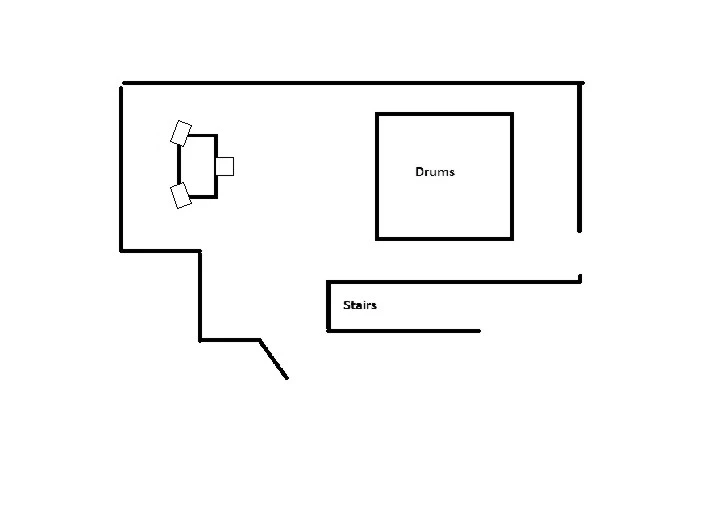

You'd be facing left, toward the window on the left wall. The curtains should help. Put some treatment on that end of the room and you'll have something like a dead end/live end setup.
I will say that the drums sound AMAZING in this space.... I did turn the desk counter clockwise and i'm basically facing the middle of that left wall now... bass did improve a lot as did the stereo image ( I use Steely Dan's AJA CD as a reference CD, IMHO one of the most sonically perfect recordings ever..). This arrangement also has the added benefit of giving me much more room in the middle of the room for rehearsal.
