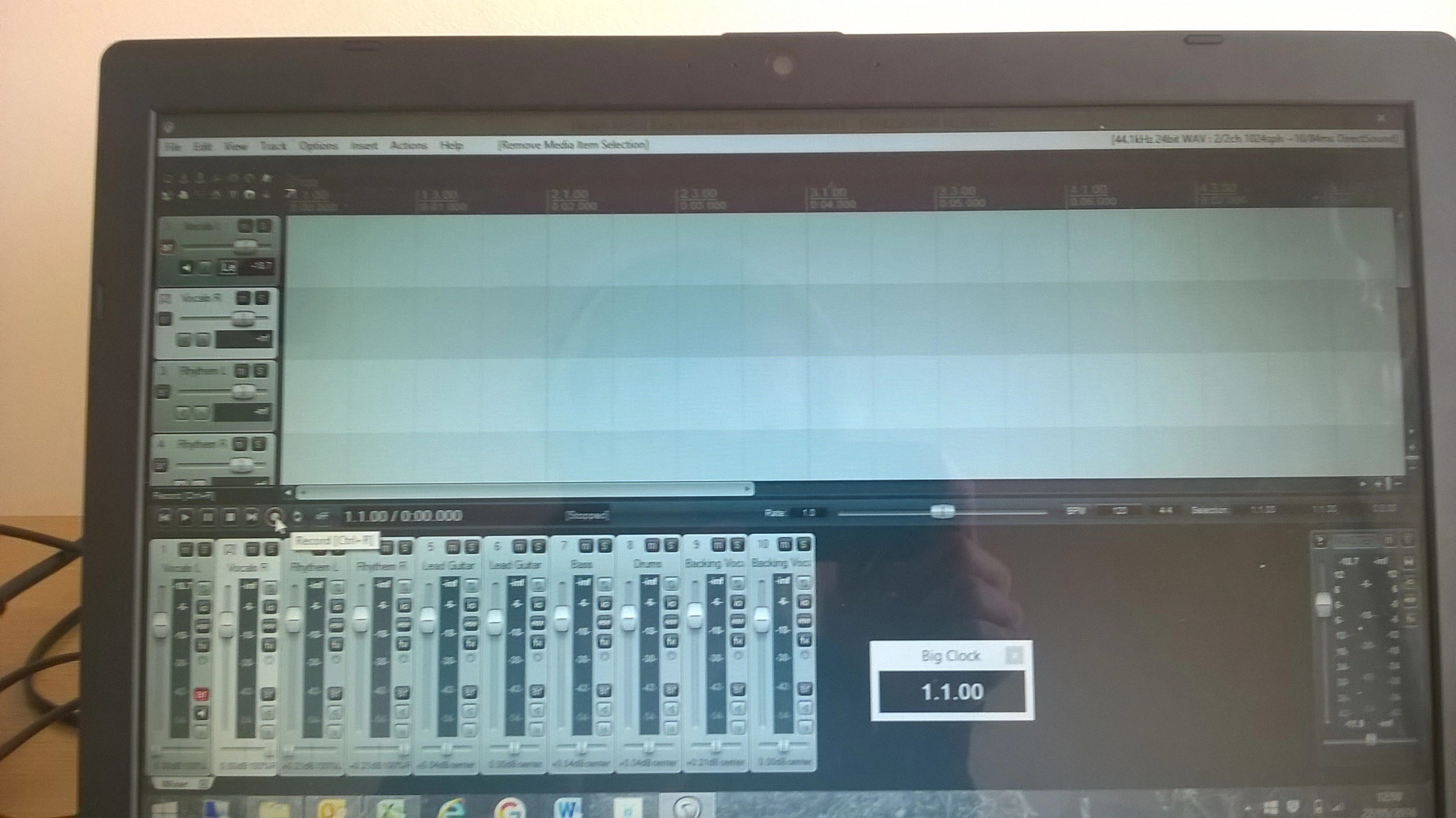

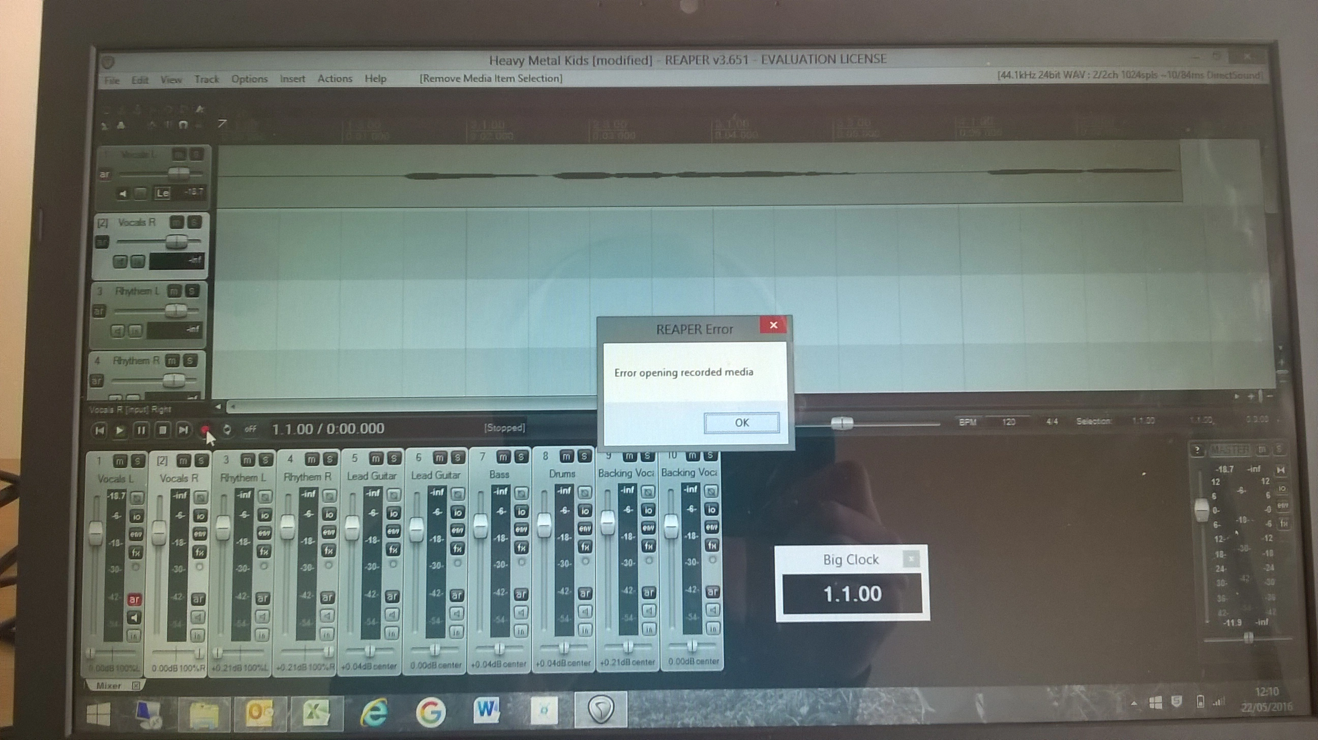

Hi! Thanks for your reply! ?
I have just done both of this things that you suggested and it is still saying the same thing!
I will post a picture of it, and then a picture of what happens when I click ok.
Thanks!
Tom0599

There are several ways of starting Reaper up.
One of the ways is 'Reaper (reset configuration to factory defaults)'.
Find this and start Reaper using it. This should get rid of any weird stuff in the configuration.
Yeah, I've seen error messages when I try to record something into a folder path that doesn't exist any more, either because I moved the folder, or bought a new computer and changed paths/folders, etc....
Go into "Preferences" and then "Paths". Make sure nothing is selected in any of the boxes. You'll see over "Default Render Path", it says "If left empty, current project directory will be used".
