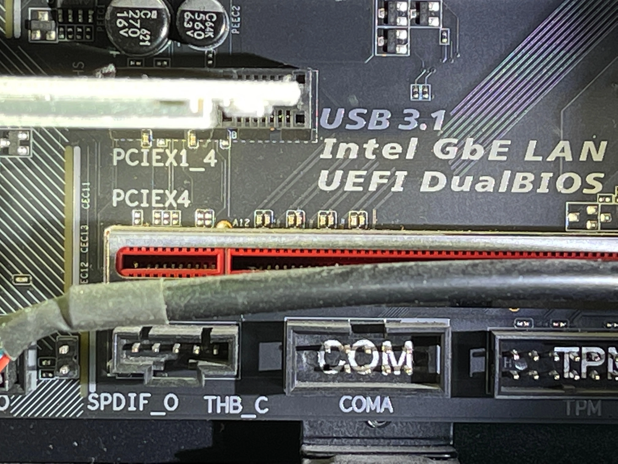

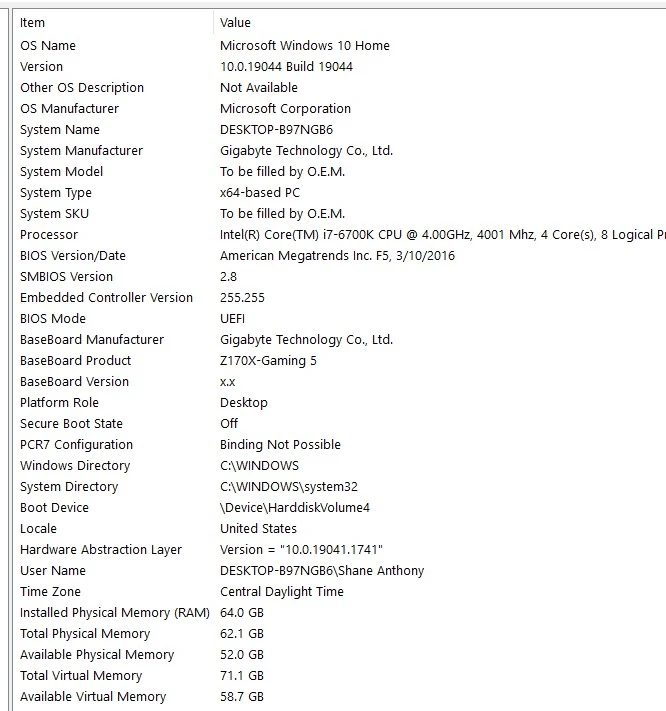

Regarding connectivity, I'm not sure which way would be best to go.
My PC has USB 3.0, and 3.1, but no Thunderbolt. I could get a Thunderbolt card for it, and get the Lynx Aurora w/Thunderbolt 3.
Or, if I bought the Lynx Aurora Dante version, could I connect it by plugging straight into one of my ethernet inputs on my PC? I've never used Dante before.
I'm not sure how MADI works.
Lynx also offers an HDX version with Digilink, but I'm not sure how that connects to my PC either.
What would be best?
