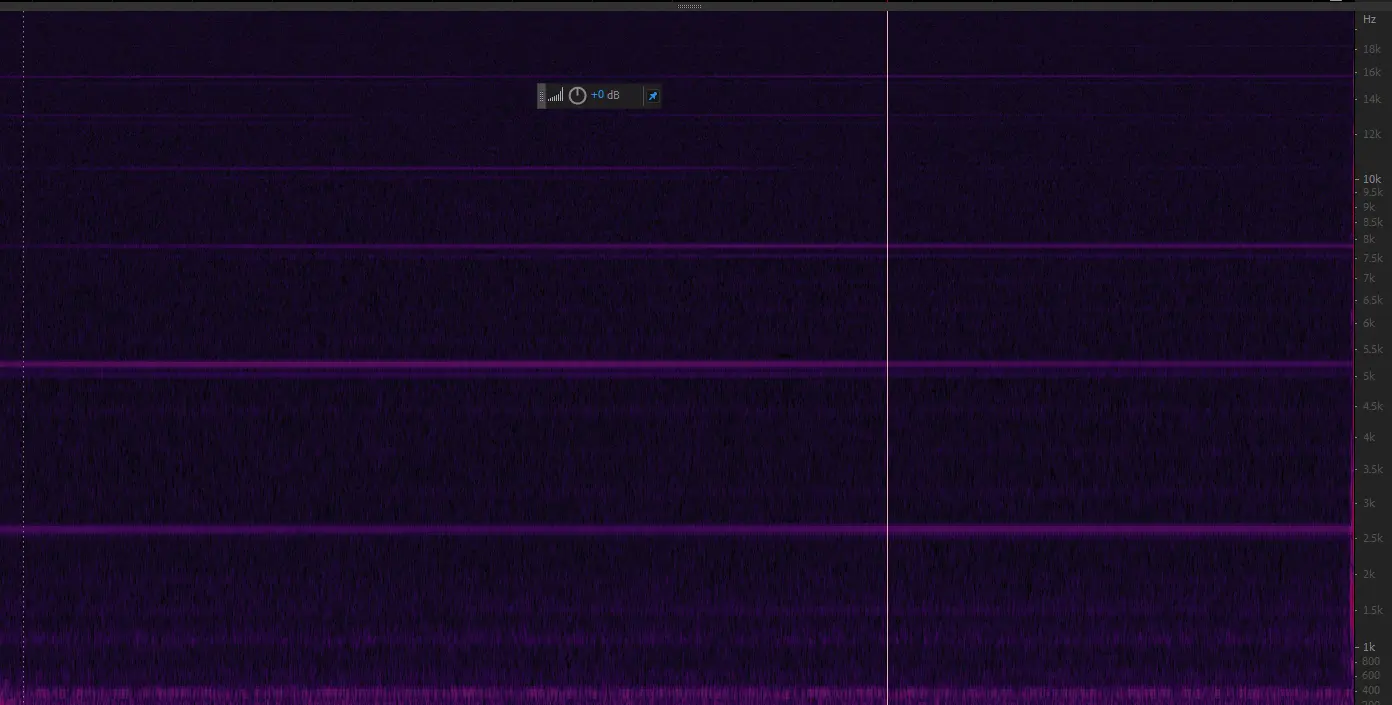

I'm recording in a basement and am trying to figure out what's making this awful noise when I record from any microphone. I have a Behringer UMC404HD USB Interface and this is what happens with any mic I record with. Anyone know typically what makes these noises? Any tips on removing them before they get to my DAW or am I stuck using noise reduction/eq?
Here's the spectral view so you can see for yourself, along with how it sounds:

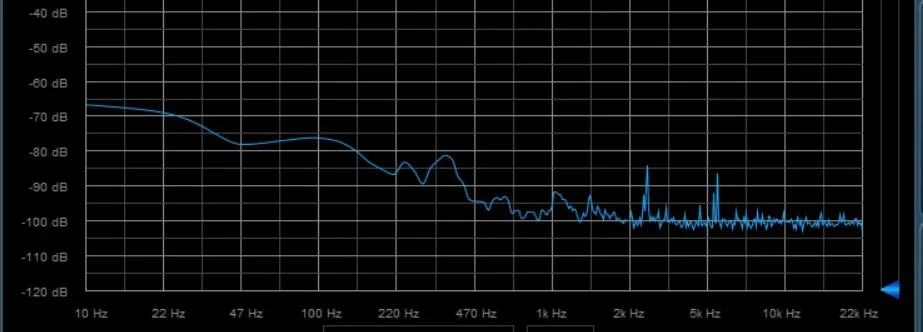

I don't hear anything either, but on your graph, you clearly have a series of harmonics. If the base frequency is about 2.6k, you have the 2nd 3rd 4th 5th and 6th harmonics visible. The level must be incredibly low, and at the level of the recording, it isn't apparent to me. I don't have a way to do it since I don't have the raw file, but if you boost the signal a bunch, does the level increase? If you plot it on a frequency vs level line graph, what levels are you seeing? -50dB? -90dB? You should see something like this:

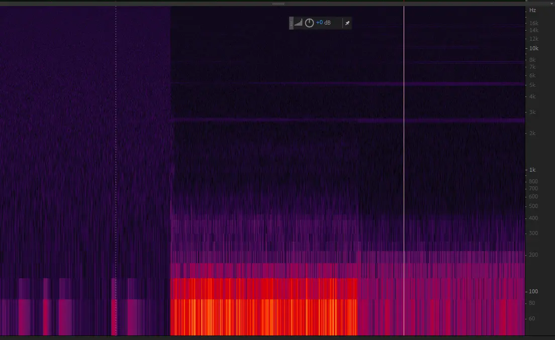

So here's a visual representation of my test. From left to right it's 1) Mic unplugged, 2) mic plugged in, and 3) mic plugged in under a couch cushion. 1649351511387.png

I downloaded the wav file just to look at it and the level is down about 85dB. Since I was just listening on a laptop speaker which doesn't get very loud anyway, I'm sure it was just a case of being below all the other noise going on. Once I pulled it into Reaper and listened with my headphones, it was very obvious.
