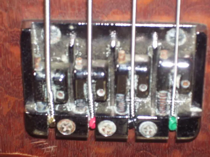

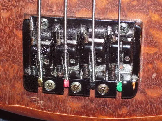

Thanks for the replies Lt and Jeff. Yes, I'll just take the whole bridge off. It's just two screws. I'd like to drop the whole thing in something and clean it off to stop it from rusting any further. I know it won't be shiny new but as long as it gets all that crud off.
I really don't think deoxit will touch that. Deoxit is made for oxidation on circuits- much less than what you have, there. Removing the bridge and mechanically removing the oxidation (wire brush, drill brush wheel, etc.) is probably the only way to get that crud off.
get some liquid wrench and let it soak over night in a little cup of the stuff ...... you'll likely be able to get them to turn.I wound up taking it off and using mystery oil to clean it and lube it and then I used isopropyl alcohol to rinse it. It cleaned up not bad, but I'll probably have to get another bridge if I ever want to adjust the action because a couple of the screws on the height adjustment are no good. Everything was pretty much stuck. I got them all going but two allen screws which stripped.
I just noticed the G string is out of the groove.
And if you stripped the allen head ..... turn the saddle over and there will probably be enough of the screw sticking out where you can grab it with some pliers. After soaking it in the Liquid Wrench you'll probably be able to remove the screw out the bottom of the saddle and then you'll just need a replacement screw.
a good guitar shop that does service work should have them or you could order them from a guitar parts supply place.Good idea. I wasn't sure if I could find those screws. Do you know if they are pretty common?
