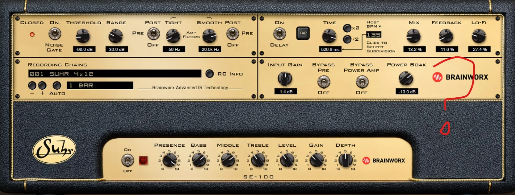

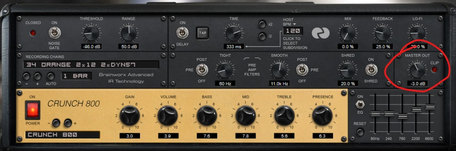

In Apollo the Unison guitar bass models are excellent. However, where is the master volume in UA Console? The Brainworx plugins have the master volume control on the GUI. Once you get the UA version for their interface, the master knob is gone. What in Console replaces it? Not input gain. Not level. Not mix. Not soak. I want a master level knob to adjust recording track volume. There has to be a way.
For now I ll use 'Level'. Level is not the same as master volume.
