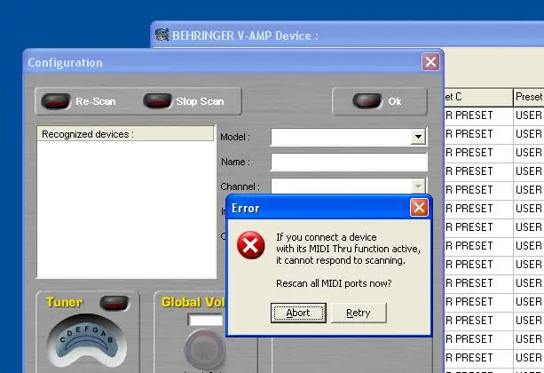

<USER> "Error message: if you connect a device with its MIDI through function active it cannot respond to scanning - rescan all MIDI ports now".
<BEHRINGER> When using the V-Amp Design editor software for Windows, you will need to use both the MIDI send and MIDI return connections - at least on start-up of the software. The software sends a request for a device ID - which must be returned to the PC via the second MIDI cable. So you need to use 2 MIDI cables.
To check the status of "MIDI THRU" / "MIDI OUT" in your V-Amp model, enter "EDIT" mode by pressing both of the arrow keys (bank up, bank down) and selecting "MIDI" (key A). In this configuration, the "TAP" key can be used to toggle between MIDI THRU (LED off) and MIDI OUT (LED on). To use your V-Amp model with the editor software you must select "MIDI THRU" (LED off)."
Is it just me or doesn't the error message say DON'T use MIDI THRU. Behringer says set the unit for MIDI THRU ?!?
Either way, I tried both settings -- no dice.

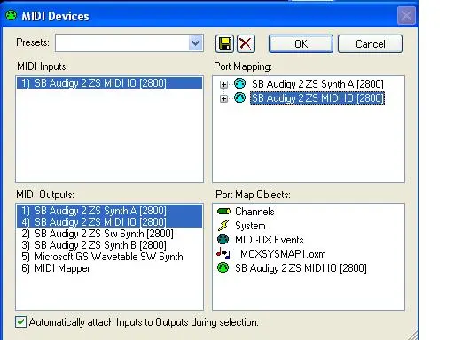

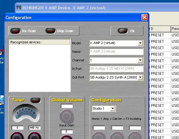

AFAIK MIDI in/out is set up on my machine.
(I'm not a MIDI expert so there could be an issue here. I have installed/enabled all the Creative devices & software related to MIDI)
I have connected the MIDI IN to MIDI OUT on the V-AMP
I have connected the MIDI OUT to MIDI IN on the V-AMP
15 pin connector ---> gameport on PC
The gameport card is connected to the Audigy so I think that is OK ... should I try a MIDI to USB connection? Is there anything else I need to do to make that work?
