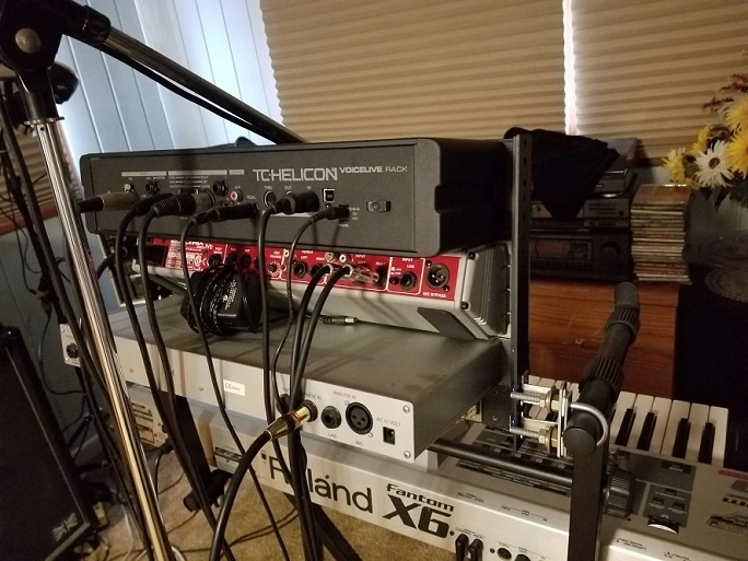

Does anyone make a rack shelf expansion for a keyboard stand? Like, I want 5-6 rack spaces right in front of my face when I play the keys.
I could find nothing. I have ideas. And a Sunday afternoon....Crowd Fund my project and I will bring to market.
A pair of 6U rack ears
$20 2 tier stand
1" U bolts
M10 hardware
Washer from box in junk drawer.

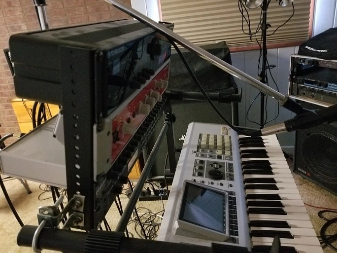

This is what I came up with.
Just like an erector set.
U bolted to the second tier.
Anchored on each side in 2 places, for stability and vertical hold.
