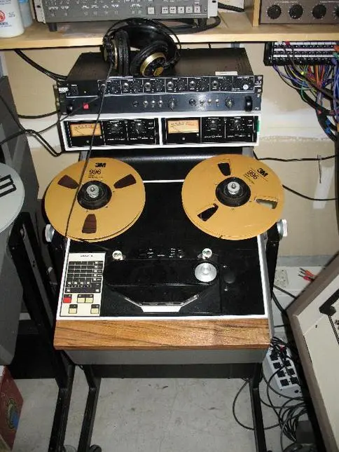

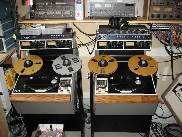

I picked up a 1/2" 2 track headblock for my ATR104 1/2" 4 track. After some days of fixing and testing and in general learning the ATR I've done the first calibration on it with the 1/2" 2 track heads.
There was the odd moment where when going by the book I could not get it to overbias 499 properly but heck, who goes by the book. I found a way to make it work.
