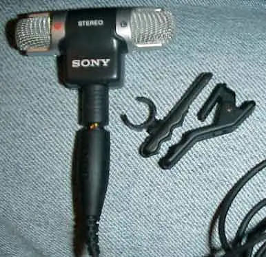

with the sony ecm--ds70p I got noise from the MD heads or mechanism doing it's thing when starting recording and ending. Picked up a lot of noise from the md and the clip broke real easy on it. I have to come up with some way to replace it, maybe rubber band and paper clip....
this mic is $74, i think. setero and looks like a T. 1/8 plug.
Got one of those EMC series. The numbers change all the time, but the mics are about the same (spec and price). Good for the price and the battery last very long. A roll of tape to steady them is useful.
