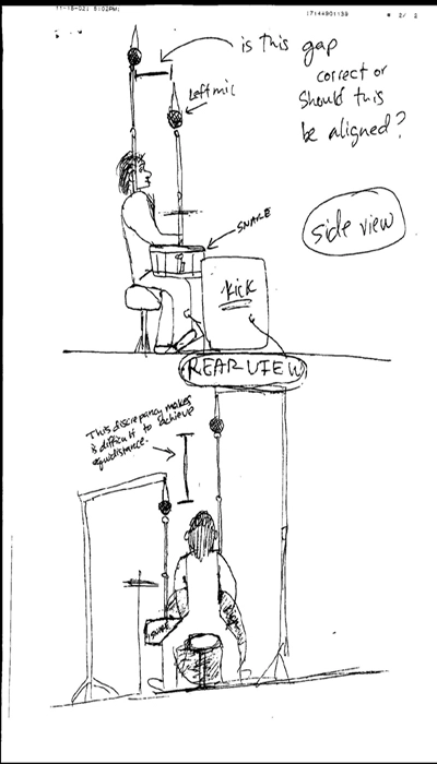

I have attached a little skecth to help illustrate how I understand this method to be.
The washer/string example is confusing as well. Once you see my illustration you'll hopefullly understand why I'm confused.

The "Rear view" text reads:
"this discrepancy makes it difficult to achieve equidistance."
Also, when considering my comments, bare in mind that I'm sticking to the original method; using two drums sticks end-to-end from 1) center of snare straight up and 2) drummers right shoulder straight up.
I think your supposed to put the second mic 2 sticks from the snare also (not 2 sticks from your shoulder), just positioned over by your right shoulder (in that area). That actually makes it (for me) 6 inches or so from my right shoulder.
That is EXACTLY the kind of clarification I'm looking for!
Thanks Ziller.
Haha, now I see... too funny....
