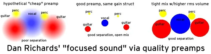

to illustrate the concept
Would this illustration explain the concept better, Dan?
(forgive me; I'm a visual thinker)

Seems to me what he's saying....
I just have a hunch that it's bunk.
