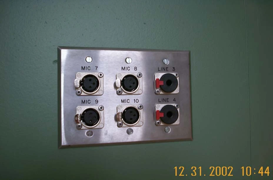

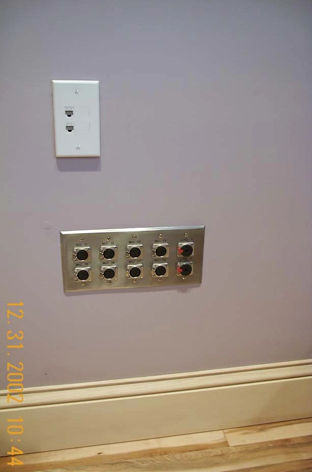

Here are a couple of my wallplates. They mount into standard wall boxes, and the snake pigtail ends come up into a floor panel with a hatch top under my desk. These were custom made and engraved by Conquest Sound. Very Slick. I think the smaller plate was around 40$ and the larger $85 with engraving.
And here's the other plate..
