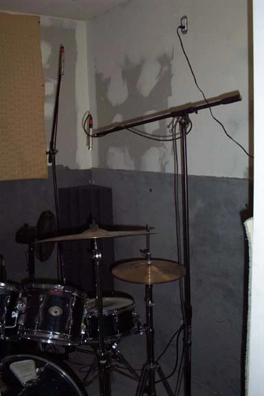

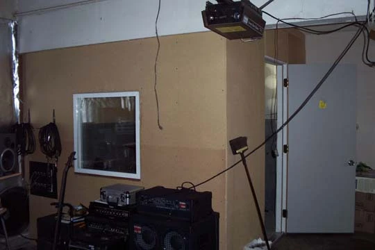

That's precisely my problem - my room is 8x8x8 - perfect nightmare. I have attached two pictures to give you an idea of what I'm talking about. Basically, I'm planning on lining the four corners with bass traps, covering the top half with auralex boards, and the bottom half with Carpet.
What do you guys think?

Second Picture
Here's another Pic.

Hey Molar...Is that a garage door opener I see in the first pic?
You should probably get rid of that...It will probably make alot of noise when you old man is pulling in the driveway getting ready to park his car after a long day at work...Why dont you get a job Slacker!!!lol
The piece of s*&t doesn't work. So we're good in that department.

adding padding to the walls, ceiling and floor to deaden the sound is a great idea, and the less bounce around you have the better it is going to be for you.
there is a formula in recording magazine's issue last month that shows you how to calculate your rooms natural standing wave frequencies.
you take the 1rst/2nd/etc. multiples of the standing wave in the X,Y and Z planes. Any frequencies between the X, Y and Z that are within 5hz of each other are a standing wave issue.
for an 8x8x8 room, the standing room in the X is the same as the standing wave in the Y, & Z.
for instance if your standing wave is at 40hz, then you are going to have a problem with 40, 80, 160, 320hz. according to Dave Moulton, after 500hz or so, you can't really notice the problem.
if i were you, i'd find a way to change the width and length of your room. my room is 14x10x8 and it sounds pretty OK, but the parallel walls are an issue.
Crosstudio
