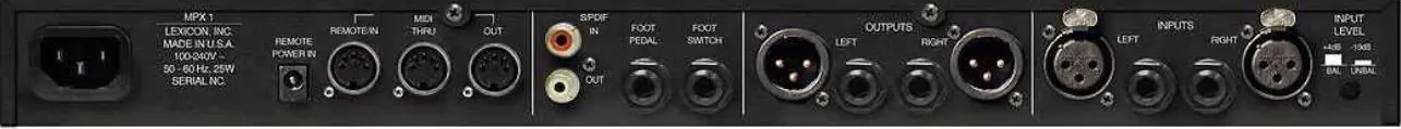

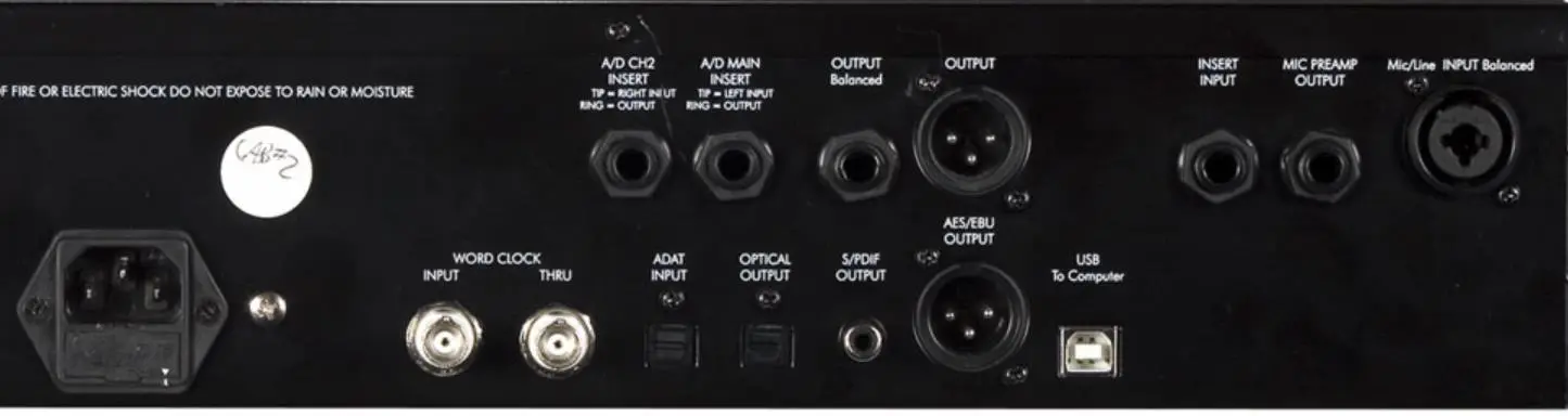

How to connect outboard reverb into the Art Voice Channel?
  • Thread starter Thread starter mofat
M
mofat
Straight from the ART manual
Mic Preamp Output
This 1/4” T/S unbalanced jack provides a direct signal from the microphone preamplifier, ahead of the EQ and dynamics processors. This output can be used in conjunction with the INSERT INPUT jack to insert external signal processors between the main preamp section and the EQ and dynamics processing of the Voice Channel™.
Insert Input
This 1/4” T/S unbalanced jack is an input to the EQ and dynamics processing sections. This input can be used in conjunction with the MIC PREAMP OUTPUT jack to insert external signal processors between the main preamp section and the EQ and dynamics processing of the Voice Channel™.
Of course, common wisdom says you shouldn't insert reverb in your tracking chain, but if you want to, go for it.
I tried reading the pdf manual but it isn't clear to me. Could someone please draw a line where the connection should be between the units? I'm just looking to sing karaoke with this.
