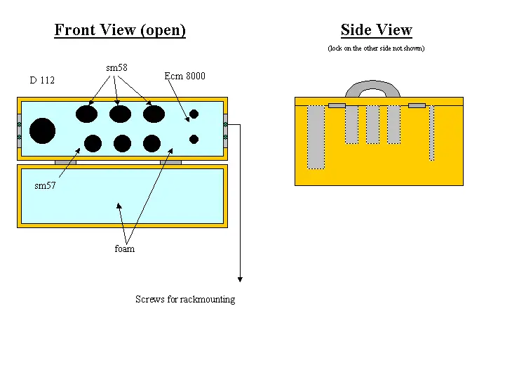

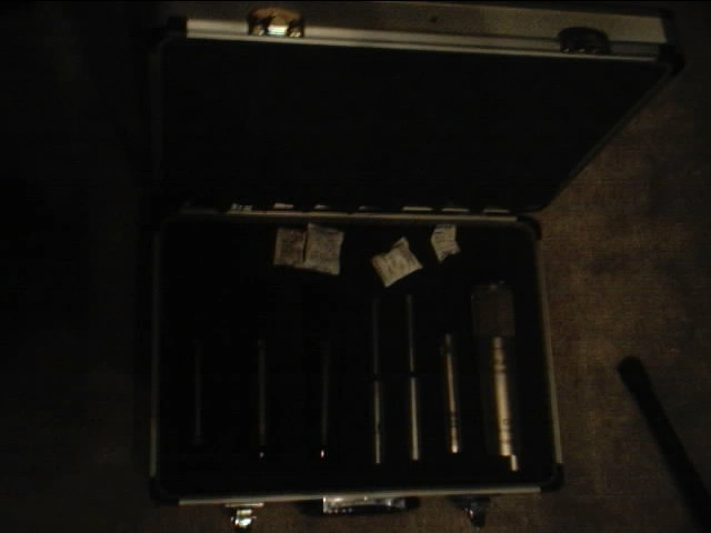

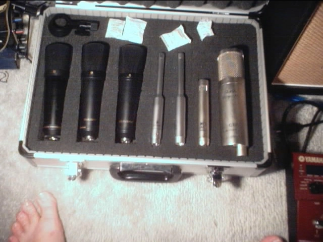

Finally found some.
I cut it to size (sharp razor blade works like a charm) and then made an outline of all my mics with a marker on the foam. I then cut out the outline and scooped out the middle area so that it fits in there nice and deep and snug. If you try this, outline one side of the mic and the top and bottom, and then roll it slighty over
towards the 1st sides line before tracing the final side. This insures that it fits nice and snug. I suggest practicing on a spare piece before taking a chance at ruining you 1st piece. Place
your mics out where you want them to get a good layout, too.
I cut out a second piece to put over the top that is just thick enough to cause pressure when the top is zipped up, so that the mics have no chance of coming free in transit.
Looks real professional, too.
