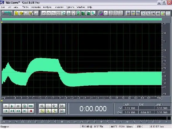

I tried again in CEP2. This time, I free up all PC's activity but the CEP2. It acts different now. The pic should tell you more than my words to describe the result on square wave test...
Anyway, it's quite tiny noises, about -55dB, I zoom it to get better pic...

James Argo said:
...it's getting weird now.
Just curious. Was it look 'square' befor the cancelling.
