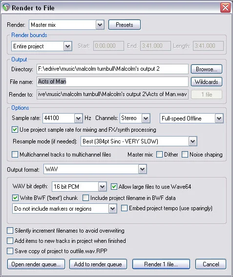

When your song is ready to export, go to "File" on the menu bar, then "Render". This will bring up a dialog box in which you can specify how you want your file to be rendered.
If you are rendering as a final product, i.e. something from which you want to make a CD, convert to an MP3, then use 44.1/16.
See the dialog box below:

Are they taking exception to the sample rate or the bit depth?
Maybe you've rendered at 20 or 24 instead of 16?
