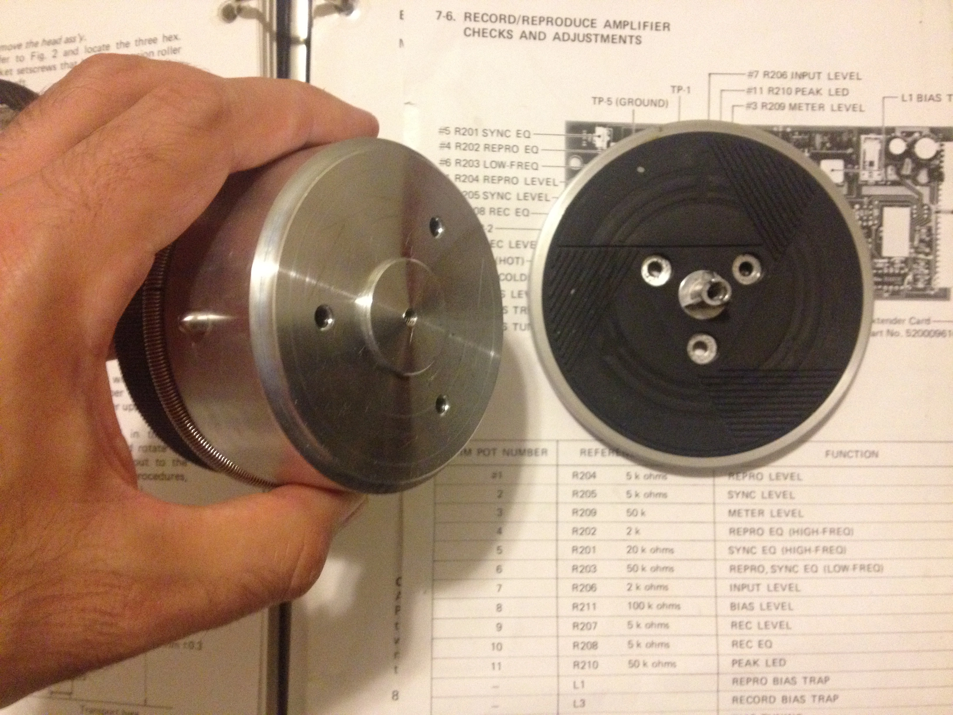

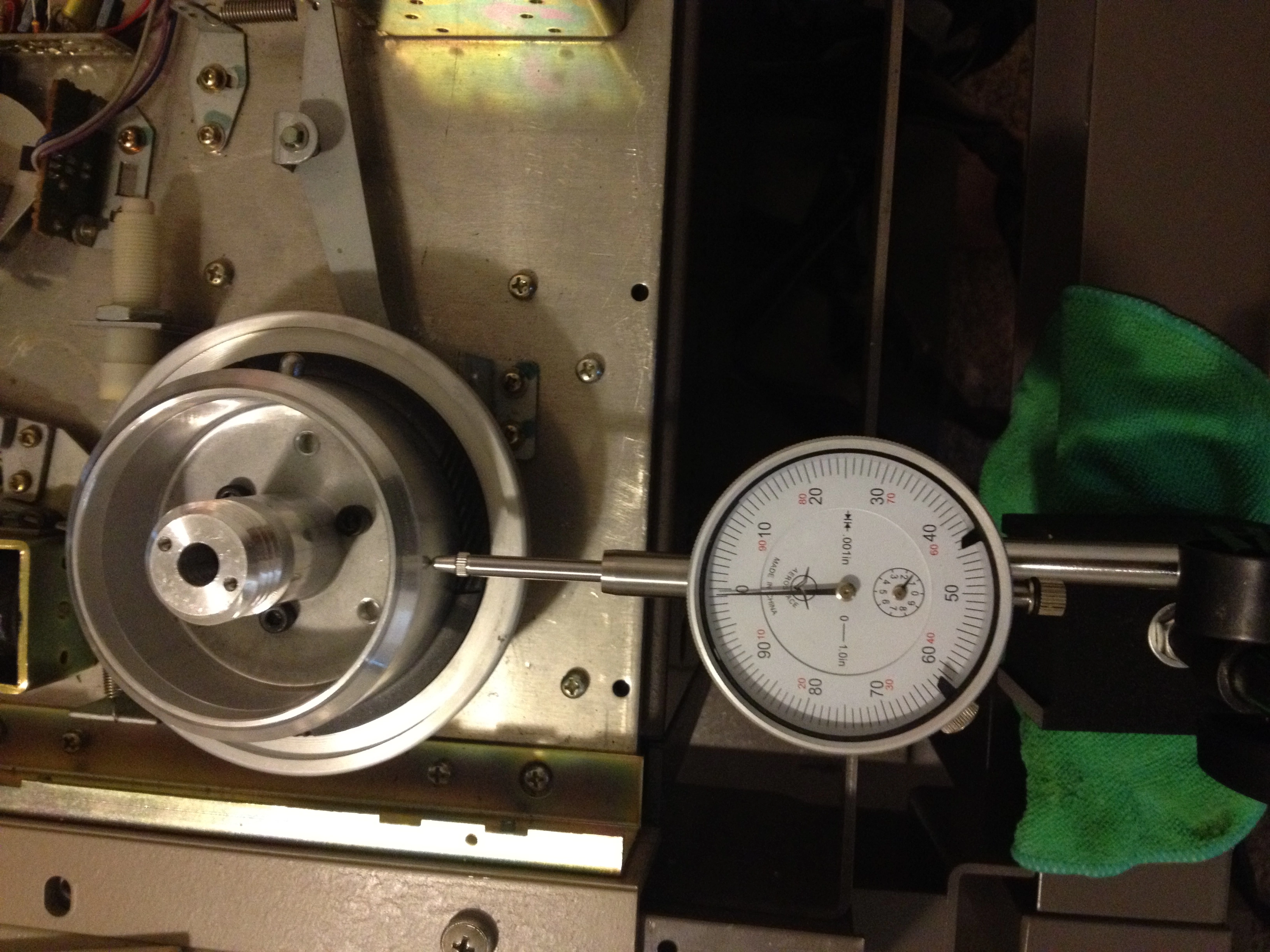

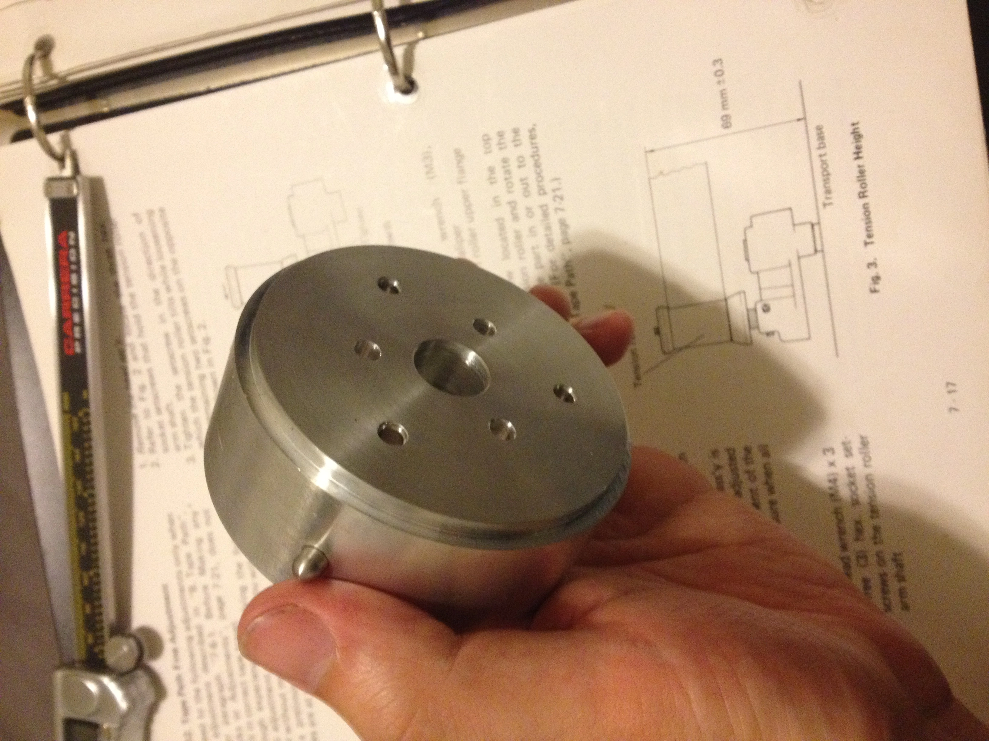

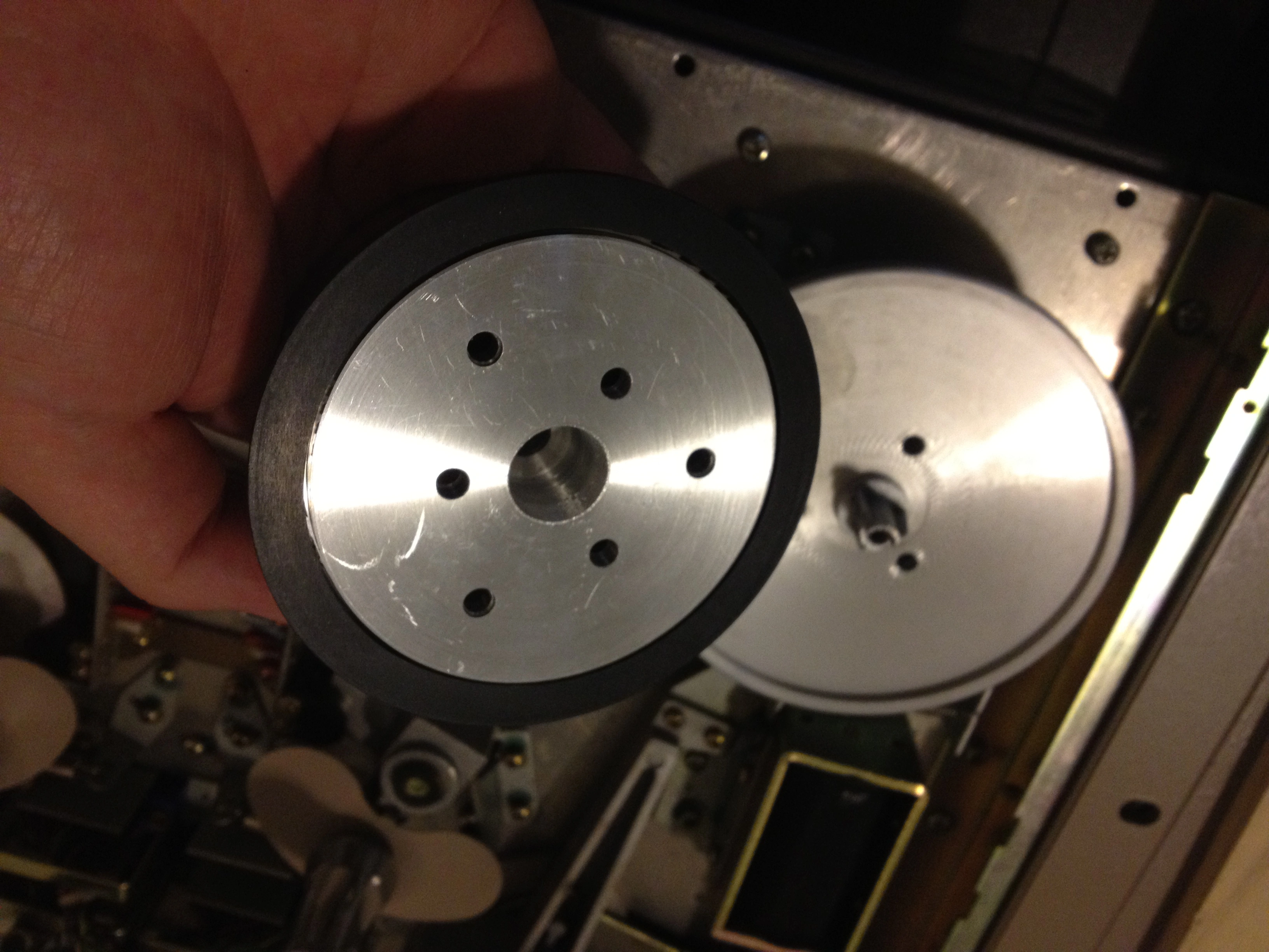

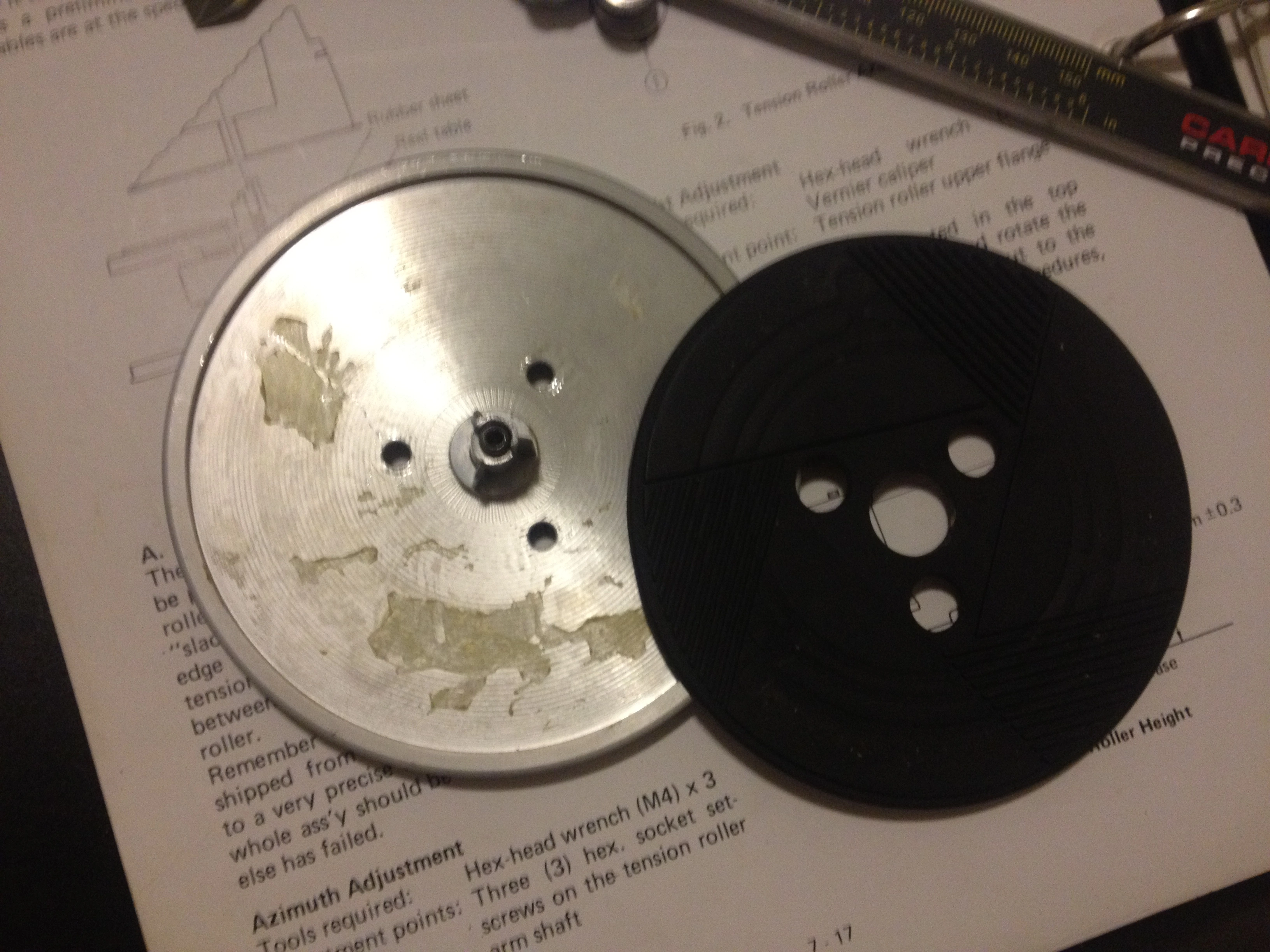

Hi, thanks for the elaborated instructions. I got one from a 1/4" that i had and fixed the plastic nab adapters as you suggested. Only issue is that they are not the same color, but they work. However to be honest having this plastic nab adapters at 1" is kind of impractical, they will break eventually, it is a weak solution.
So i've been looking online for alternatives specially the TZ65 metal clampers, which are unobtanium. However i found a pair for the MSR24 which is also a tascam 1" machine. They looked the same, unfortunately they are not identical at the bottom. So i am now thinking how to modify them to make them fit into the MS16 reel table.
Here's the situation:
https://picasaweb.google.com/lh/photo/9n46-7COMS0j_j0IwM8OYZFYXbWTWDvLVRcv-4KsFNY?feat=directlink
Basically what i need to do is:
1. Drill "D" and enlarge it to 1/2" so "B" can fit on it.
2. Somehow center the two parts, so i can drill holes in the aluminum piece on the left to match the holes in "C"
3. "A" maybe a problem so may need to chop it off somehow and flatten the whole thing. i can also remove the black rubber in the reel table, but may need to push down the reel table too much and it may not have enough travel to compensate for the extra height.
Opinions ? any other ideas?
Thanks
Felipe
alright, so finally i have my hub adapters on the MS16, thanks to a donor MSR24 that saw a shorter lifespan than its parent MS16...
