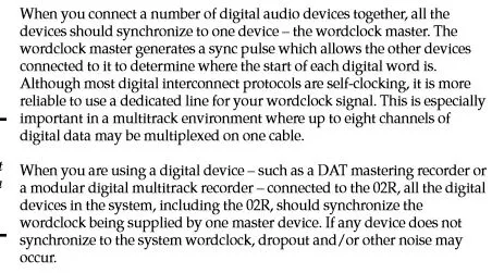

In my Yamaha O2R manual and the HD24 manual it states you will get better results if using multiple digital devises by slaving them to dedicated worldclock and they both mention being able slave to an ADAT BRC. I have a BRC, it has one Worldclock BNC output, both the HD24 and O2R have one BNC connector for worldclock in. My question is, since it doesn't explain in either manual, how am I to slave both the O2R and HD24s world clock to the BRC if it only has one out?
