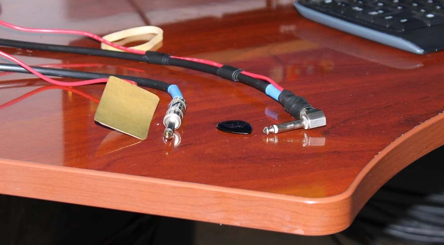

For those who record electric guitars...whether through mic'ing or going direct...we all know the frustration of dealing with intermittent ground noise due to fingers touching (or not touching - as the case may be) the strings.
This eliminates the issue 100%....and then some.
A stripped wire end contacts either end of the plug and fixed with tape in this case. The other end is soldered to the brass plate and that plate is placed into your waistband or sock, making contact with your skin.
If you try this....you won't go back because you get the kind of ground that only happens when you lick your hand and rest it on the bridge.
Galvanic skin potential explains why this idea below works so well. The skin of your waist conducts electricity better than the calluses on your fingertips. There's also a MUCH larger contact area with the brass plate than through your fingertips.
BTW...you're not trying very hard to record something noise free if you haven't licked your hand yet.
