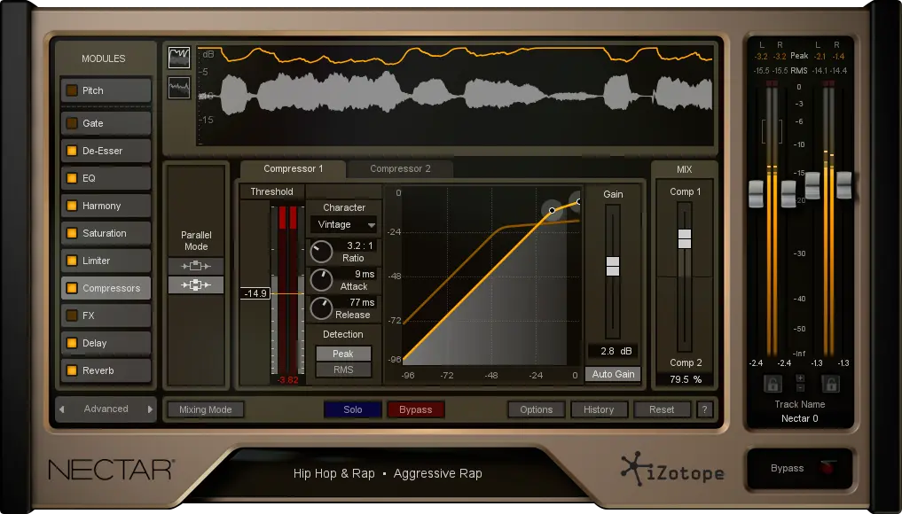

Yes there are plug ins that have multiple compression steps in a single plug in/process. iZotope Nectar. izotope-nectar2-compressor-full.png
