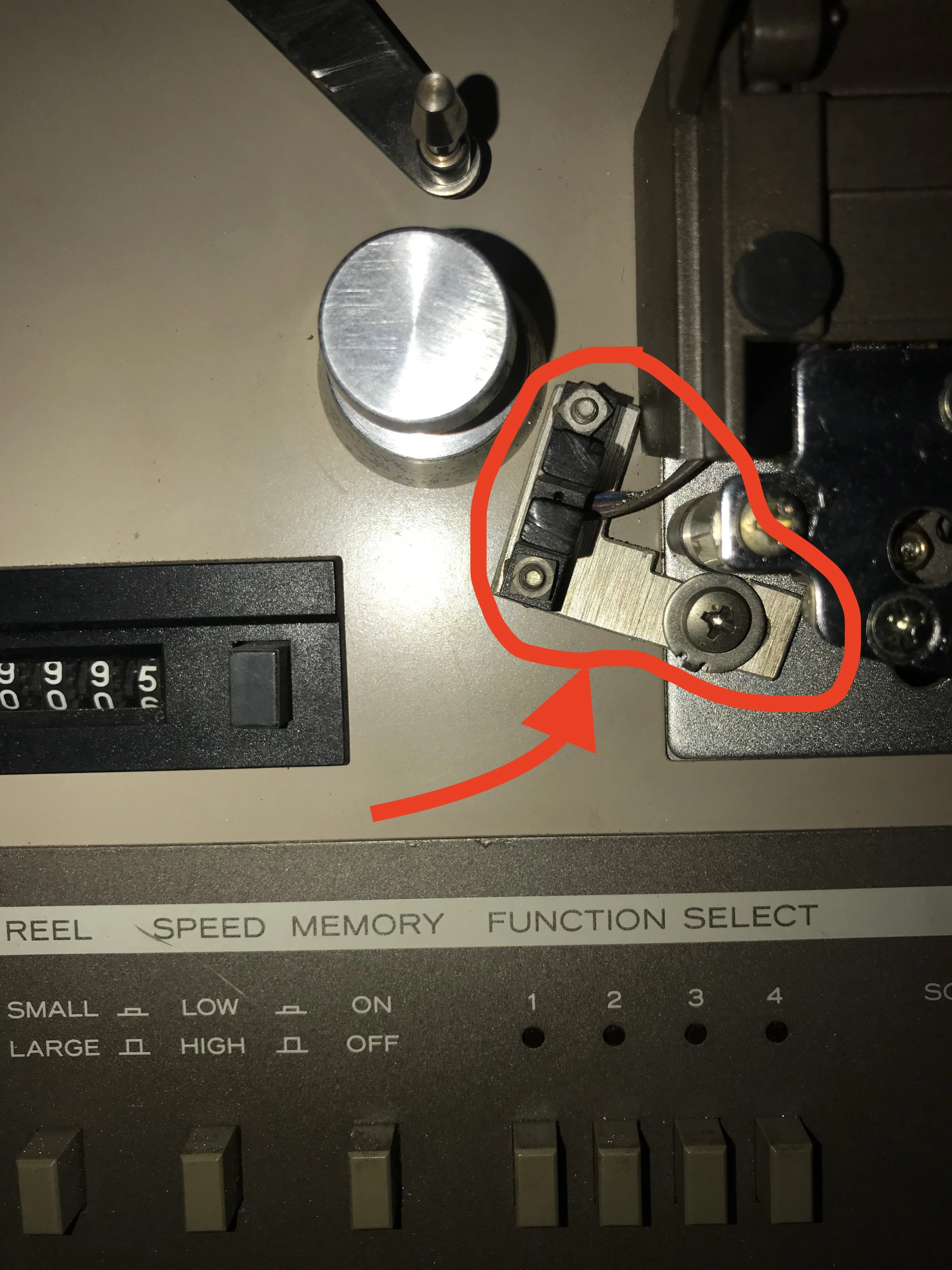

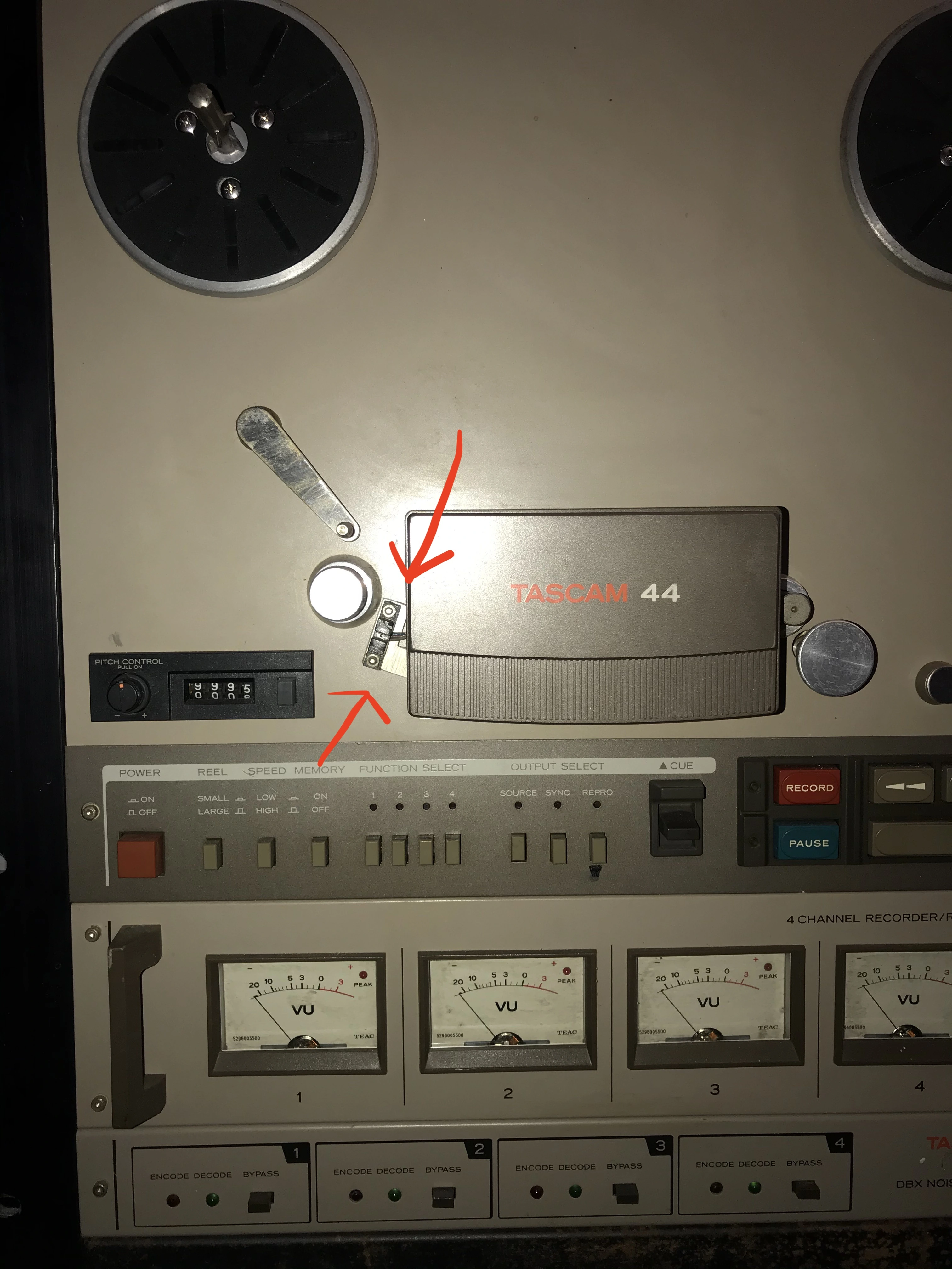

I just got this Tascam 44 (Early Model), Im noticing there's a piece of metal and small wire screwed on next to the tape heads that doesn't seem to be on other machines when I look at pictures.... It seems like its not supposed to be there, and would interfere with the tape.... Anyone know what this is or how to fix it?
Looks to me like the tape is supposed to go in-between the two black posts...so I don't think it will interfere.
What is if for...?...hard to say. Since it is wired, it must be meant to read something off the tape...maybe sync code...?
Look on the back of the machine...are there any mods there, like some type of connector?
If you can trace where the wires go...that will certainly help tell what it's for.
Looks like some kind of tape present sensor to me. There is likely to be an infra red (or possibly visible light) transmitter on one side and a receiver on the other side. The beam is interrupted by the tape. It may well be something that has been added to the machine or possibly Tascam decided at a late stage that it was needed and there was no time to design a better mounting system for the early production units. Quite a few other machines use something similar.
As JamesPerrett says, that's almost certainly a tape presence sensor. You'll see a similar device on the Studer A807 and even the Revox B77. The added-on look is very strange, though.
I am also betting tape sensor.
