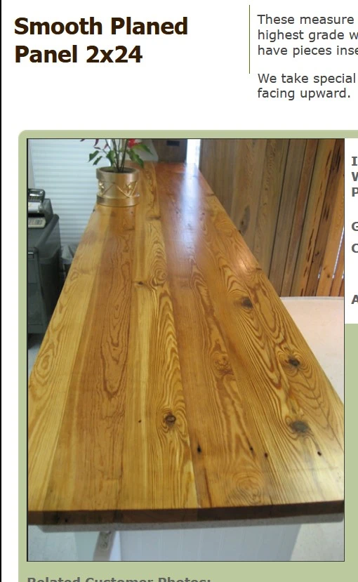

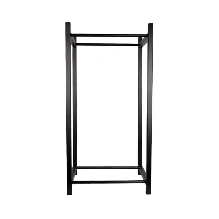

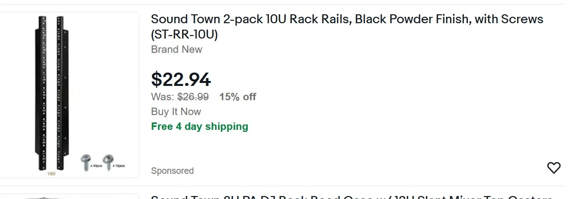

Inside? Get a couple 2x24" laminated panels. Grab a pair of rack rails. Build a box using 1x2" supports. Screw the rails onto the box. Put your stuff in the rack you built.
