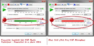

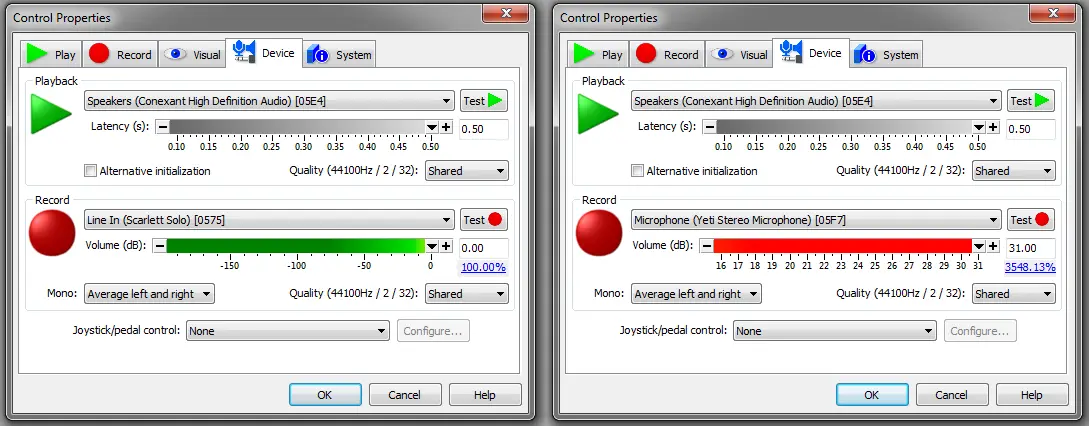

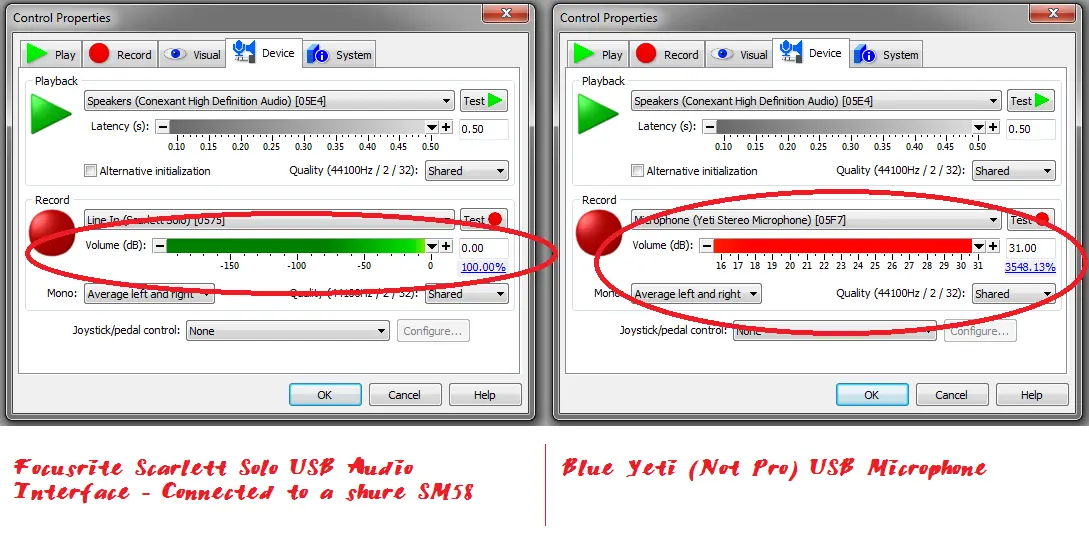

Using GoldWave, a digital audio editor, I noticed something strange with the gain strengths of my Scarlett Solo interface vs my Blue Yeti. I've attached a picture showing my observations.
Notice the color of the Volume (dB) bar and the numbers to the right.
For the Blue Yeti, the number to the right (not sure if it's called the Gain Boost or not) is up to 3548.13%! The bar is red, meaning it can record such a high level of signal that the channel can become hot and therefore distort the signal.
Yet, for the Scarlett Solo, notice that the color of the Volume (dB) bar is green (signifying a quiet signal) and the number to the right is a mere 100% (which I'm assuming means no Gain Boost or "none of something" for whatever that number may signify; it's the default level).
So my question is... What gives?

You're using Line In on one and Mic In on the other... the Mic In will be more sensitive.
Also...you have mic/interface on one...and USB direct on the other...so you may not be staging the gain equally and relatively to make a direct comparison between them.
Your Scarlett should have its own Mic gain....and separate Line out...so fist adjust the Mic In to get a nice solid signal going into the Scarlett and then adjust the output to get a good signal into the computer.
With the USB mic...you're just adjusting in the computer.
(If I understood your process correctly)
The Blue Yeti is a condenser mic, so it naturally has more gain than the SM58 which is a dynamic one (and a quiet dynamic one, if I may put it like that)
That aligned with the fact that the Yeti is connected via USB, make the gain go up high, because the only connection you have between the mic and the capture device is a USB cable (maybe the Blue Yeti has some internal circuitry that could reduce the signal without losing quality, but IDK). If you could pick up another condenser and plug it into your interface you would see that the gain will be much more controlled.
The interface has preamps and proper D/A converters that will make the signal ideal for recording purposes in a PC or Mac, or any digital recording medium. So the noise will be significantly lower without losing the quality of the signal.

Yes, that Solo has much lower gain* than is going to be useful with a 57/58 (and a claimed EIN of a poorish 125dB. But then, noise speccs are ALWAYS SUS!) The AI seems to use ASIO drivers and so will be its own "thing" as far as the computer is concerned but often this can be changed in the DAW.
The Yeti being USB is totally at the mercy of the OS for setting gain. (but ASIO4all might help there?)

Others have gone into a lot more detail but let me just say that there's nothing strange about your Yeti outperforming an SM58 in a home studio.
The SM58 is designed for live use on a stage with lots of loud sound going on around it. It's strength is rejecting sounds other than a mouth singing or yelling loudly an inch or two away and not giving too much feedback when amplified. However, sensitivity and sound quality are not its strong points and frequently you DO have to crank you input pre amp up into a range where any noise will become apparent.
The Yeti, on the other hand, is designed for recording use in a studio. It's quite a bit more sensitive and also offers a flatter frequency response especially at upper frequencies. It's far from the best condenser around...but it's designed for the sort of thing you're doing, not live work on a stage. Indeed, in some situations, the sensitivity will be a problem if you start to pick up lots of background noise from the room.

The Yeti has almost 2.5 times the signal output of the SM58 for the same audio pressure level at its diaphragm. It's somewhat typical for a condenser mic to have a "hotter" output than a dynamic type of mic.
Shure SM58 sensitivity
Cardioid (1.85 mV/Pa; 50 - 15,000 Hz)
Blue Yeti sensitivity
Omnidirectional (4.5 mV/Pa; 180 - 20,000 Hz)
Cardioid (4.5 mV/Pa; 150 - 15,000 Hz)
Bidirectional (4.5 mV/Pa; 100 - 15,000 Hz)
X/Y Stereo (4.5 mV/Pa; 80 - 15,000 Hz)
