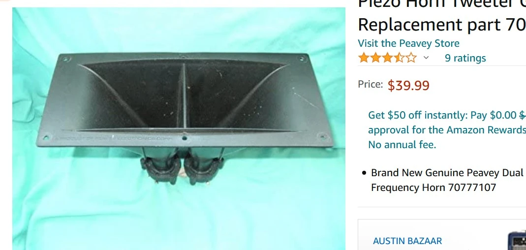

Yeah. everyone had those terrible Peavey cabinets with the PEIZO dual horn section. The peizo dual horn array did not even have an impedance.. It was not needed. They couldn't handle much. The cabinets armed with them were garbage.
