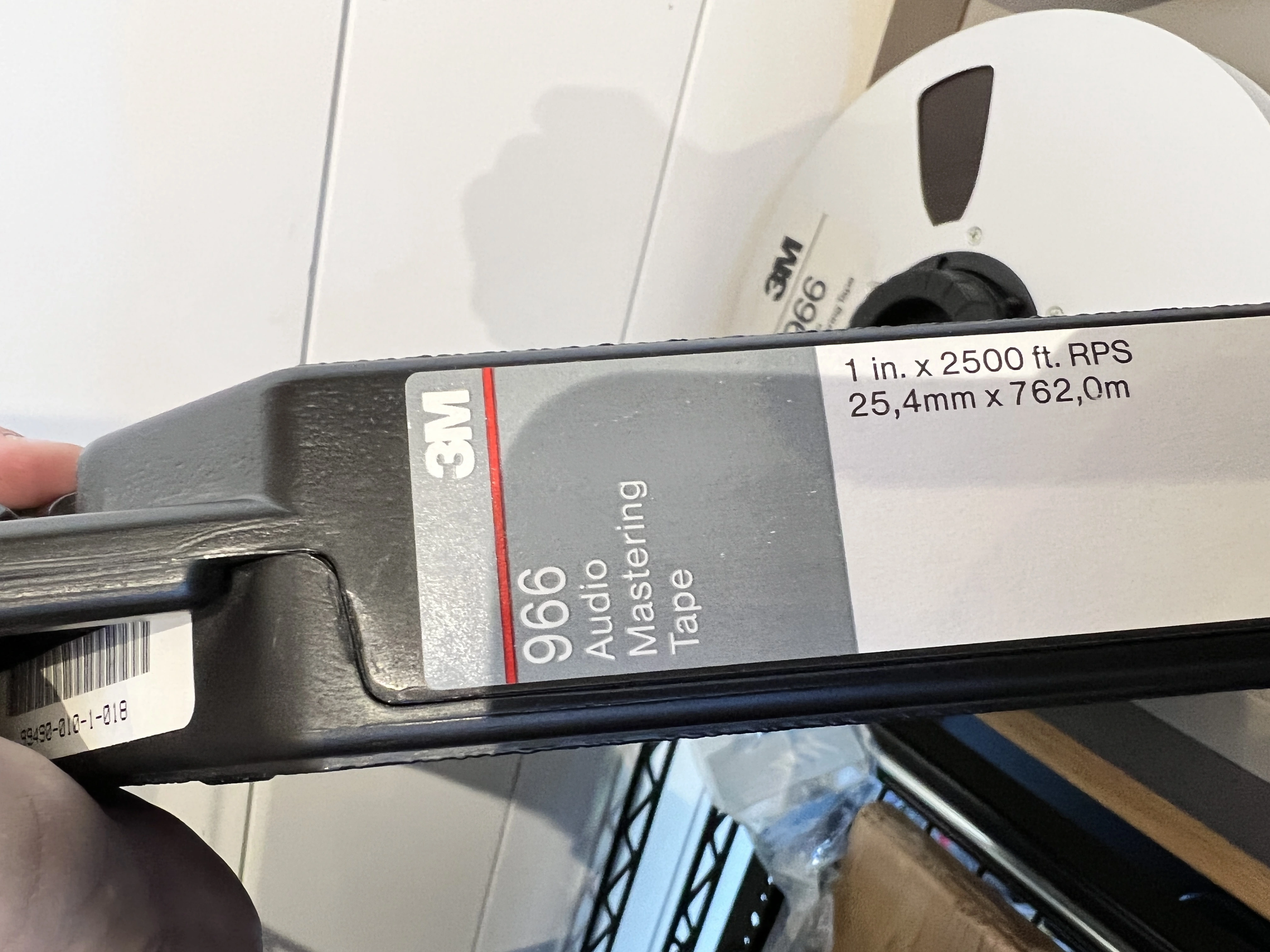

I think you mean 996. Regardless, if a tape has sticky-shed, don't use it for production even after baking. It's a false economy. Get new tape.My Tascam MS-16 came with three NOS reels of 966. How do I know if I need to bake them to use or are they sticky shed safe. They appear to be in excellent condition, visually, and appear unused, tails out with manufacturer’s tape on them in plastic cases. TIA
Thanks, dyslexic momentI think you mean 996. Regardless, if a tape has sticky-shed, don't use it for production even after baking. It's a false economy. Get new tape.
Yup, it’s bad. It didn’t come tails out (per the instruction sheet inside), so I was loading to a reel and it started to slow down halfway though, left a bunch of gunk on the lifters, but I never hit play. Cleaned up the machine after I rewound it back to it’s original reel.The only way to know is see how the tape behaves on your machine. If you hear any kind of mechanical squeal or excess friction as it plays, get it away from the heads & off of the machine.
Ditch it. Don’t keep it and bake it repeatedly. Fools errand, bad idea, etc. the only reason to bake tape is to transfer material off the tape. And you typically cannot tell if tape is bad until you thread it up and run it. Sometimes you’ll know right away, like squealing, or sometimes a full servo tension machine will just act weird, jerking action on the tension arms, that kind of thing…and then of course in extreme cases the oxide will just scrape right off the base onto your tape path in a pile of zombie skin goo. But almost always it looks okay to the eye. But if you ever get ready to thread it and anything flakes off or it seems tacky to itself, bake it, transfer it, dump it, or if there’s no material on it, trash it. That’s why it’s important to know what tapes are almost always bad, and those that are suspect. No sense damaging your machine if it’s known garbage. And unfortunately the list is growing all the time. Late Ampex branded or Quantegy branded 499 has always been pretty safe, but I’ve got some 1” Ampex 499 that squeals, and some 1/2” Quantegy 499 that does the same thing.
I agree, I’m going to ditch it, snag the reels for future pancake purchases (if I can find 1” in pancake form)I think 966 was renamed 986 later on. It was 3M's equivalent of Ampex 456 whereas Ampex came out with 499 for use at elevated levels after 3M came out with 996. I used some 966 back in the 1990s and it has now gone slightly sticky - not as bad as Ampex from the same era but not usable without baking.
