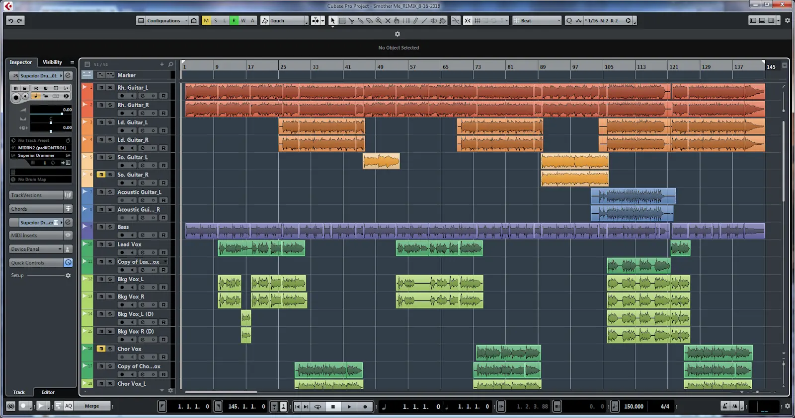

Haven't read all the comments but I would like to reiterate this.
record and mix with levels averaging at around -18dBFS.
Don't worry about volume or loudness until you have all your songs done are ready to put them together as an album.
It is my understanding that most of these tracks were recorded many years ago, so you can't do much for the recorded levels except retrack. But now you can simply bring the faders down for all the tracks so the meters are around the middle of the scale.
I like to start with kick, snare, bass and lead vocal and get them all sounding good together. Then bring in everything else in a supporting role. In this song, you're mixing like a guitar player. Take that hat off and put on your producer hat. Do what is necessary to serve the song.
Good tune and great start. You're like 80% there with this mix.

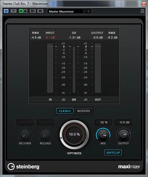

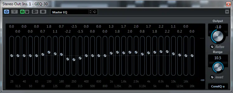

First thing I'd do - pull all the faders back down to "-". Completely off. Remove any plugins where gain is added (compressors, limiters) or change their settings back to default, but leave tonal fx, and then start over. You don't have to scrap EVERY plugin, keep the shaping ones, but ditch the gain-inducing ones so you're back at a minimal volume. Just how I'd approach it.
If you want to completely remix, then just remove all plugins and start fresh. I've done this before.
I think andrushkiwt has good advice here......as usual. Go back and pick one song to start with. Don't worry that it'll be much work. You have the basic tracks done. That's the hard part. Take all the FX off. Get your raw tracks as low as possible gain wise. Stratomaster and bouldersoundguy and Chili (above) list where the upper level target should be. I've done this before too..............and it seemed like it was going to be a GIANT PITA........but it soon became one of the best learning experiences I've had. Realize that everything you learn in correcting your first song or two will be far more easily and quickly applied in those that follow........and it's a great feeling when it's over.

After reading all of both threads... (see my advice in the other thread). You don't have to "remix" your entire album... you probably only need to back off the levels (using Mix Busses, i.e. Vocal Bus, Drum Bus, Bass Bus, Guitar Bus to route your relevant tracks to a "single" fader makes it easier to set levels, just for future reference) and re-work your "Master Fader", i.e. reset your "mastering" plugins and use Reference Tracks (said Foo Fighters songs) and just fix the LOUDness problem to be closer to said Reference Tracks. Don't take people's comments to think you should "give up", as that's not what anyone is saying to you. Everyone's comments have been nothing but positive. As far as my "Gain Staging" advice in the other thread, use that for the next time you record a song and you will have a better starting point for your mixes.

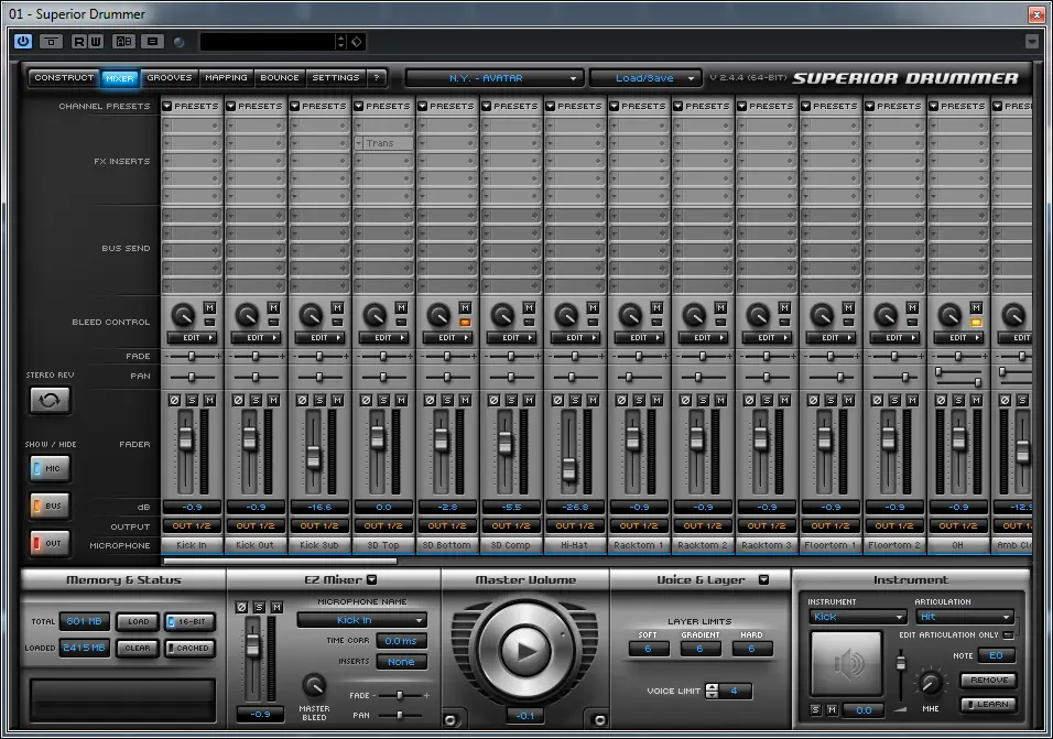

I didn't care too much for the drum samples. The snare is much wetter than any of the other tracks. I guess the cymbal samples aren't bad.
Thanks, Trip. Lots of lessons learned on these songs. Time to find a new recording process/method. I did some research last night, and everyone's saying "set your levels at -18" or something like that. I put everything at 0 all the time and try to get the hottest input signal possible. And if it's not hot -- I jack it up with the "increase gain" function in Cubase. LOL!
I'm eager to see what it sounds like if I record/mix everything low on the next song and try to jack it up a little at the end.

Your recording levels might be too high. But what I'm hearing is what I think is happening after tracking, like a limiter. Or Cubase's "increase gain" function. I don't know Cubase, but it might just be a limiter. Anyway, I would lighten up on that, at least when you're posting here. Afterwards, if you're giving it to your friends, or whatever, limit it to your heart's content. IF that's what you want to do.
Oh and setting your recording levels to 0... The common -18 recommendation is dbFS. Hitting 0 dbFS on all your individual tracks would likely cause very audible clipping. I'm not hearing that. So I'm thinking your 0 recording level is either a peak it's 0 or on another scale (i.e., not dbFS). Maybe dbVU
