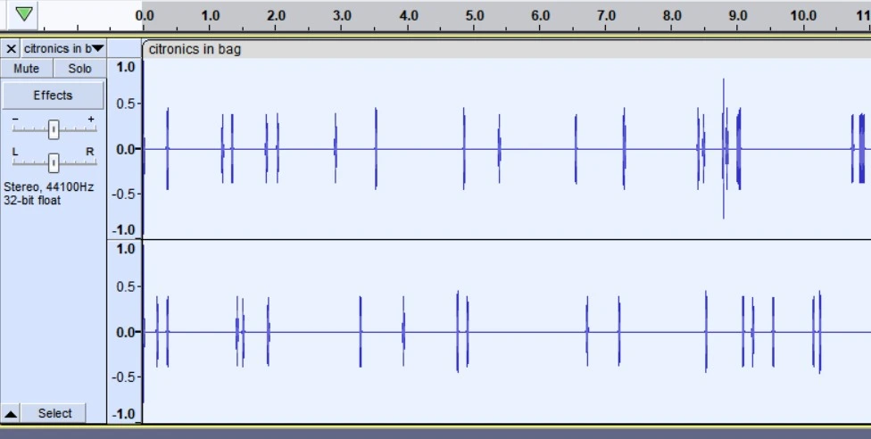

Thanks Rich. Very difficult running tests so far apart! Since we both have a Citronics USB mic I have tried to record a 'baseline' noise level. I wrapped the mic in a cloth and put it in a padded guitar back in a small, quiet bedroom (I have a long USB cable through the wall for my printer) I found the Windows setting for the mic was at 95% so set that to 100% so that son could run the same test.
Attached is my result. When originally done as a 16bit .wav the noise was a bit above -90dBFS, about right for 16 bits. Converted to 320k MP3 might have changed that a bit. My next task is to get son to repeat the exercise his end with his Citronics and then the Mackie. Once I have some hard data that the mic is noisier than it should be we can tackle Amazon.

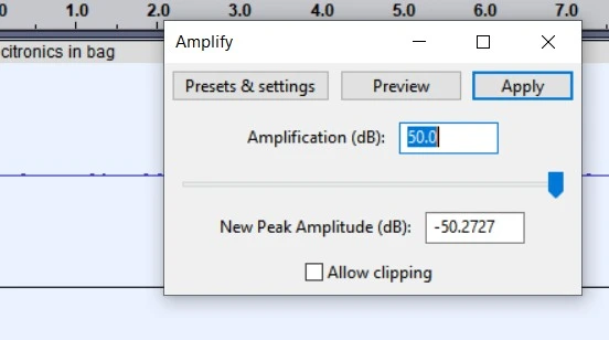

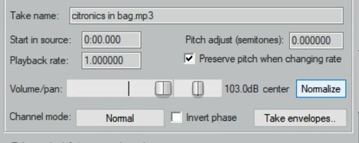

I put the Citronics file into Audacity and heard .... nothing! So I highlighted the file and hit Amplify. It suggested 50dB with a resulting peak of -50dB, so that's 100dB boost to get to a peak. I thought that strange, so I put it in Reaper and clicked Properties. Under that tab, it has a "normalize" button which said 103dB, so yeah, it's incredibly quiet.
Once I bumped that level, what you hear are beeps and boops, not hiss. I'm not sure where they come from but it makes me think the noise level was being recorded below -98dB, the lower limit for 16bit, and/or the 320kbp MP3 conversion. I don't know that I've ever encountered a mic that was below 100dB.

I am obliged Rich. Yes, the recordings throw up some anomalies for me as well. I have played them in Samplitude Pro x3 and SE8 and the noise APPEARS to be below -90dBFS. Not likely? One very odd result is that the MP3 version gives a poor result of around -75dBFS in Audacity.
I am going to repeat the tests but with the mic 'open' in my living room, make a noise then STFUp for 20!
