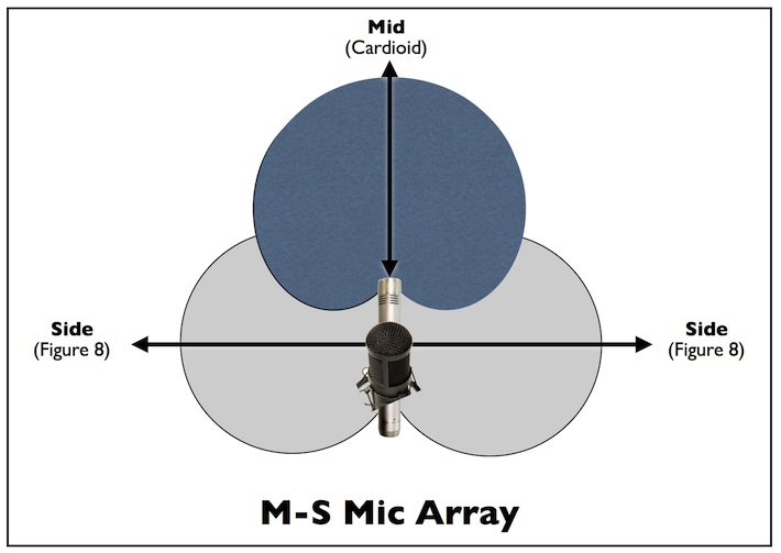

Re Blumlein MS, it’s definitely not rotated. Traditional MS your capsules are 45° relative to the source. In Blumlein MS, you have the mid directly on axis just like any other MS pair. The two Blumlein methods are the same except for any capsule irregularities based on angle to the source, which I think you eleuded to. Better mics should be less problematic. I’ve got a pair of MKH30’s so I’m good. :)
We'll just have to disagree - not to worry. They become different patterns based on the ratio of mid to side which changes with frequency. Your diagram shows the 45 degree rotation compared with the normal orientation of two fig-8 in Blumlein. The two mics have a resultant 'direction' at 0 degrees (with one 45 left and one 45 right) M/S have forward and backwards at 0/180, and the side 90/270, so the 'middle' is rotated.

No, we're just talking about rotation when looking at the orientation of the array - Blumlein is oriented to different commas positions than an M/S array doing the same thing, that's all. It's not a problem, just an interesting fact. Blumlein, with it's main focus of direction from the two mics at +45 and -45 has a discernible front and rear, despite these only being formed by the sum of the left and right being equal in the forward direction - being formed by the polar pattern only just starting to decay. In the M/S, the forward direction is the forward mode of the fig-8. The sideways facing fig-8 provides the usual M/S side component. The result is the same, but the M/S and Blumlein arrays are in a different position for this same effect, 45 degrees rotated. That's kind of interesting. Two identical microphones that provide left to right stereo field by pointing in different directions.
There is a difference however in the rear. Blumlein has the rear field swapped around - front right is also rear left. In the M/S version, the have frontal and rear pickup, but the left and right components are front and rear left and front and rear right. In a typical church setting. The annoying person with a cough behind the microphone would be on the other side in Blumlein, compared to M/S. I don't know for certain, but I think this is what adds the special 'bigger' sound that Blumlein has compared to M/S? I've not read any research on the rear swapping impact, but it probably does add to the overall sound. Maybe this is why the use of fig-8 or omni for centre channel is not that popular? One of those diagrams also looks a bit out of proportion - the fig-8 side with cardioid. It's drawn so that the cardioid ONLY is forward of the side mic centre, when the polar pattern of the cardioid for the same pressure points would be drawn further back, so the cardioid centre is towards the back. I think the person who drew it distorted it to make a point.
