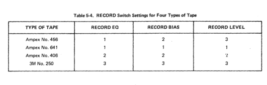

406 and many are +3 tapes. On my 2-track one three position switch reduces level to the meter, so it stays at 0 level. So, I should be able to meter normal, +3, and +6 tapes
And there are hotter formulations
