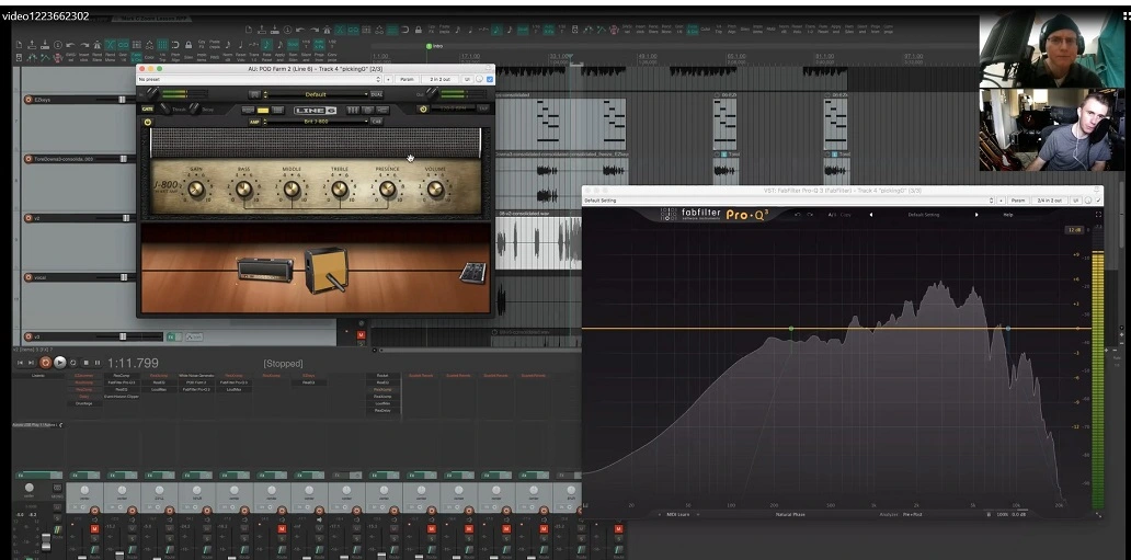

Have you tried any Zoom meetings or youtube streams with the online educators? There are a few that do Zoom meetings and you can be a guest on their recording podcast. You can ask questions as they go along. Up load tracks to onedrive, you recorded and they use as a teaching aid for the show. I would contact them. Todd Leon is one. William Kenny. 5 Great Tones guy. It helps to watch someone else do it.
Since someone liked the idea.
I did Zoom meeting as a guest for an online seminar. There is a bunch of little boxes on a screen and they have people in them. The host goes to a box and the discussion begins. Everybody can see and hear each other, but we were told to mute our microphones until we were on. Prior I had sent a track to his email address. He had a link for a shared folder. In the podcast he used the track for an example and answered my questions. To see how you sweep the EQs and generally watching them use the tools was awesome. All the VSTs used are linked and free as a trial . Everybody and every track is different, but how they use the tools is the same. I highly recommend reaching out to a youtube online educator. I had a great experience doing it. In the OP interests I would see if they have anything scheduled for a Melodyne or Antares seminar. The one I did was strictly mixing.
