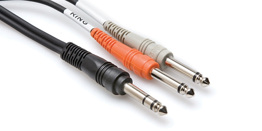

Get a 6,3mm jack Y cable (or try searching "insert cable") and drag it from Control room out to hp amp input.
Yes, the Behringer will accept a headhone input or a line input (max level +15dBu =about 3Vrms.Input Z 100k. I cheated and dldd the manual!)
You can run headphone signals to virtually any distance because of the relatively high signal level and the very low source resistance. You also don't need shielded cables but it should not hurt if you do.
You can run the headphones amp off of the headphones output with the cable pictured above, or you could connect it to the control room output, since you aren't using it to run your monitors.
With few exceptions, all of the outputs on a mixer are the same. The only difference is what you have to do to route the signal to it. Son any of the mixers outputs can be used to feed the headphone amp, just choose the one that is the most efficient for your purpose. (control room outputs in your case.)

So the cord should be TRS ---> (2) TS connections, but its ok for them all to be TRS I imagine as well.

No, they can't all be trs if you are splitting from a headphone output to a separate left and right input on a headphone amp. The tip is the left channel and the ring is the right channel. That cable pictured above takes the tip of the TRS and connects it to one TS end and the ring is connected to the other TS end, splitting it into two separate cables. If you just get a TRS 'Y' cable, you will just end up with the left channel in both ears.
The most useful output in your situation (having the monitors connected to the main output) would be the control room out connected to the headphone amp with two separate cables. That way, on most mixers, you can send something different to the headphones than you are sending to the main outputs.

No, you would need the TRS to 2 TS cable pictured above to do that too. You would just use it backwards.
