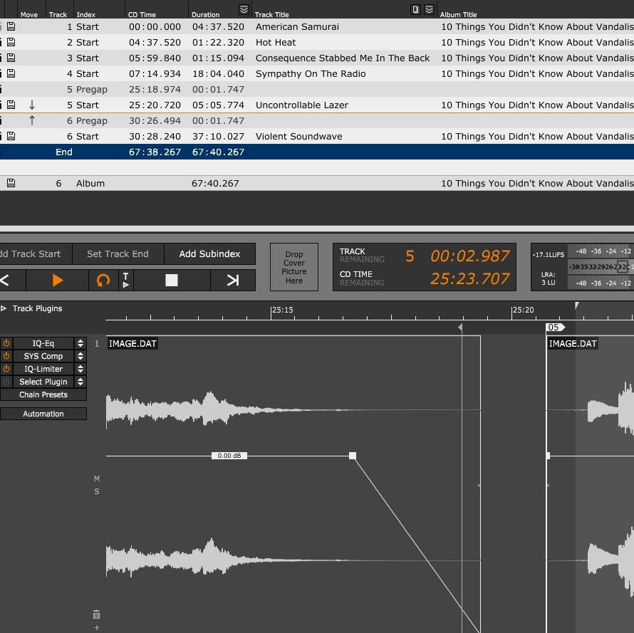

Some software - I used to use Sound Forge or Sony CD Architect - these would insert the ISRC codes - which you can get from various sources, and they would insert the gap between tracks, or miss it out when you want tracks to run on without stopping. Level wise - it's not a set figure as it's material dependent and instead of following rigid rules, I'd just look at the level of tracks that are similar and match them - a bit of typing, entering the meta data and that's it really. Get the suitable software and the meta data options are there. The Sony software still has a trial version available I think.

I have never created a CD for replication. HOFA is the reference I was given to create the DDP master *file* if that is something that you can submit to whatever replication provider you choose, if you want to have complete control over the final CD, i.e., vs. providing individual songs and hoping it turns out Ok, I suppose. I did play with the free versions of their software back a few years ago but have not tried them since. There are likely others in this business, but here's a link to start looking at, if you want to experiment.

That stage is traditionally called mastering. What we tend to call mastering nowadays is only a small part of the traditional process where the end product would have been a master lacquer. Nowadays you would normally create a DDP file set for CD replication/duplication although some smaller duplicators may still insist on a master CD. Keith's suggestion of the HOFA software is good if you want a standalone program to do this but other software like Reaper can produce DDP files nowadays.
DDP 2.0 is the superior file type (actually, a set of files) for CD duplication. It has error detection built in. But a CUE/BIN set can also work. Either of those is technically a master, though an actual physical mold might be considered a master for a pressed (rather than burned) CD.
