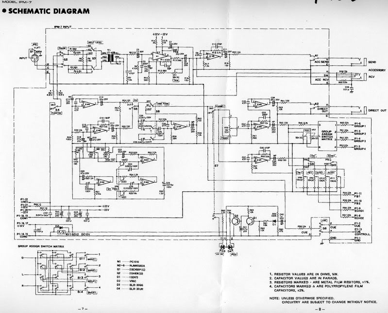

The main areas I need help in are finding schematics for the damn thing, and I need some suggestions for the solo/mute circuit. I'm thinking optocouplers fed by the B+ line off the power supply and controld by a small toggle on each channel. I'm assuming adding phase inversion should be pretty easily done through toggle switching? Or would optos be cleaner for this?
