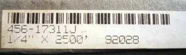

Look and see if there is a label on the tape box that looks something like the pic below. The label is usually on the edge of the box. There could be a label on the reel itself on the back flange.
In the pic below there is a string of numbers to the right that begins with 92. The first two digits represent the year the tape was made. If it starts with 94 or below your tape probably has sticky shed syndrome. For example if your number is 89217 your tape was made in 1989 and is no good.
It will cause various problems including the machine running at a slow speed from increased friction. If your tape is too old you will need to get a new reel to properly test your E-16.

oh and my tapes are - '92 - sticky sticky and 98 sticky if the player working or ok if the player is bust.
