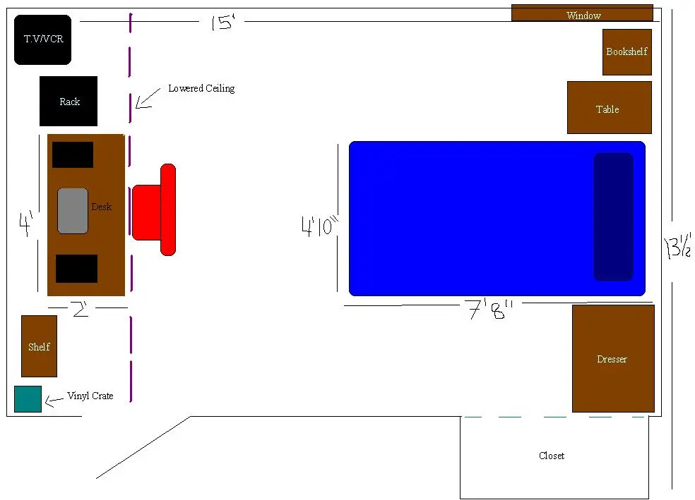

Hello Everyone:
I have a 15'x13 1/2' bedroom studio (i.e. it actually has my bed and whatnot in it). The ceiling is lowered about a foot for about a forth of the way into the room (over the front wall)
I use the room mostly for mixing, as well as recording acoustic guitar, auxiliary percussion, and 'reamping' drum tracks (playing sequenced drums through my speakers for a some room sound). Everything else (electric guitars, keys) are recorded direct or sequenced.
I've done my best to make my room symetrical, and have spent some time getting my monitor speakers (Yorkville YSM-1) in the best positions. The room has a pretty noticible ring (which I take to be "flutter echo") from a series of early reflections. The bed acts as a great absorber, and the book shelf and dresser serve as okay diffusors.
I've purchased 48 1'x1' squares of 3-inch foam from www.foambymail.com on ebay (48 squares for $84) I also have 4 LERND basstraps that I got during the Mars closeout. I plan on getting a few acoustic blankets, if necessary. [I also have some fairly dense eggshell pads. I know they only work in the highs, but I do have a pretty severve ring...I sure they can't hurt]
I have no idea where to put my new foam (in a very attractive orange!) I believe I need to make my front wall absorpant at all frequencies, and do a little work on the ceiling immediately over the desk. I need the bass traps to be movable so I can use them in my closet/isolation booth when necessary. Would it help to mount them (using T-pins) directly behind each monitor..?
I'll need about 8 pieces to finish my iso booth, so I have 40 3inch pieces to work with. I'd be willing to spend about $25-30 more for a piece of 703 or some blankets, but other than that I need to alot my funds elsewhere.
Any suggestions would be wonderful :D Below is a (badly drawn) layout of my room....not perfectly to scale, but hopefully a good representation.
Thanks A Million
Chris

How high is your ceiling?
The best places for your foam are any spots that are going to reflect the sound from your monitors back to your ears. Get a mirror and someone to move it along the walls & ceiling while you sit in your mix postion. Anywhere you can see your monitors in the mirrror needs to be treated. If you have any left over place it in alternating spots on opposing surfaces. I recommend putting most of the leftovers on the ceiling.
If you can mount the foam away from the wall/ceiling it will be more effective.
Here's a tip: unused speakers and instrument cases double as bass-traps. I store my PA speakers/cases in the corners of my studio, and it does make a difference.;)

My ceiling 7'8" for most of the room, and 6'9" where it drops (which I presume is for duct work)
I believe I'll give the mirror trick a shot. Does it work for the vertical axis and the horizontal?
One more bit of info: My speakers are about 2 feet from the wall. Because I have to live in my room as well, this is as far out as my desk can be without cluttering my walking space. If I were to move my desk out a foot or two just when I was mixing/auditioning sounds, would I have to rearrange my new foam for the new position? It seems if I went the mirror route, it would make a huge difference

Hey Chrisjob and guys - just one thing about this business of having it dead behind your monitors, I think Craig mentioned it.
You are treating the room so that the monitors sound better - right? speakers are directional - the frequency range that foam absorbs is from around 800hz up. What coming from the speaker is directional i.e. heading past you for for the rear of the room - not the front. what does go to the front is low frequencies and they are not going to be affected by foam.
If you want to use your foam wisely - use it behind and above you.

You guys are making too big of a deal about the air cavity behind the foam. A few inches hardly does anything dramatic. You need a foot before you can even affect the low mid range.
Excellent point about foam not being effective at low freqs where most cheap speakers are pretty much omnidirectional.
Don't forget about the sides. ;)
