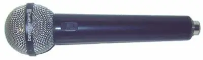

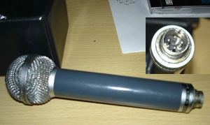

No, but they are different. Some people like roll off and others don't. Depends on how you plan to use it as well. The new mic is geared more for close micing, which is what most of us home studio types do most often. If you were hoping to match it with an older M260, of course you would have issues. I have 2 older M260s, and they are different as well. I prefer the older of the two (gray straight barrel, tuchel connector) to the more recent one (black tapered barrel, xlr connector). The older one has more output and sounds smoother - although it may be the case that my more recent one needs some work. I use it as a cab mic (but back from the amp) together with a dynamic mic (on the grill). It works OK as a vocal mic as well, but I generally like the M500 better for that.
cool, I'm not worried...I mainly bought it for micing guitar, but have just heard how they work well for overheads, so I'll probably have to get a second for a different overhead flavor than my Oktavas.
So these new ones have a tapered barrel? I haven't seen any pics of any like that...
I was referring to the two versions of the older M260. One (the oldest) has a straight barrel, and the more recent one has a tapered barrel. Both are discontinued. See attached pics. My more recent M260 does not have a switch, however, which is just as well. These are pics off the web, although my older M260 looks just like the mic on the left. I was too lazy to go get a camera out.

Cool, thanks for the info, pohaku.
